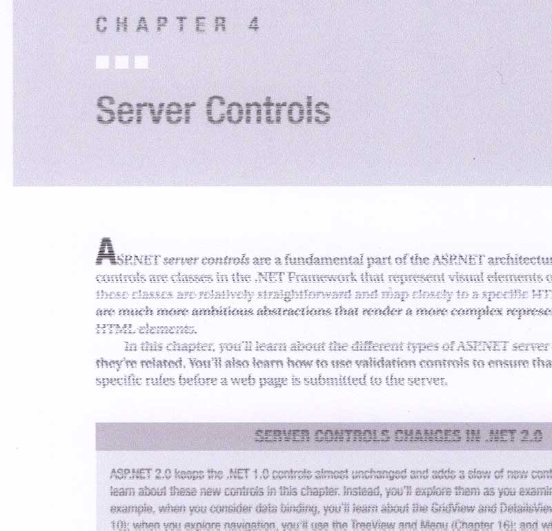

    Hi All,
    I'm having a problem with my Canon mp390 printer, it's printing text all stripy (see attached image). The blocks of colour seem to work properly (although admittedly I've only tried printing in monochrome) but the text isn't legible. I've tried aligning the printer heads, cleaning and deep cleaning them, but it made no difference, so I'm guessing it must be the actual heads or something.
    Since I just took this printer in to get repaired for a duff paper feed (still annoyed they didn't print a test sheet and spot this problem!), I was wondering whether you'd know how easy this problem would be for me to fix? How much are the parts are likely to be? and is there any tutorials on this?

    the printer is either got an empty black ink tank or you need to replace the print head, get a replacement black ink tank first (you'll be able to use a spare ink tank later)
    BTW: it looks the same when you need to replace the print head or replace an ink tank

    Didn't realise both problems looked the same. Also, I forgot to mention but I replaced both ink tanks with no change in printing quality. How do I go about changing the print head, is this easy?

    You may not realise this, but the print heads for an inkjet printer are not stored in the printer itself, but in the cartridges. Therefore should a 'print head' become faulty, the problem is easily resolved by buying a new print cartridge.
    If you have already replaced the cartridges and the problem persists, I can think of only a few reasons for this:
    1) Check the printer quality settings in the printer's properties dialog box. Make sure the quality settings are set to 'normal' or 'best'. 'Draft' quality usually yeilds the kind of output you are getting at the moment.
    2) Reinstall the printer drivers. Download the most up-to-date drivers from the manufacturer's website.
    3) The paper feed is still mis-functioning. Feeding the paper too fast with no consistancy.

    it's definitely an inkjet, are you sure they're stored on the cartridge though, because there are auctions such as this on ebay which are a lot more than the cartridges I buy, so I'm not convinced that they're the same. Could this be the case?

    I've performed a few of the tests on there and the text is still stripy, so I'm still thinking that the print head must need replacing, and that an ebay auction is my best bet, even if I then take it to someone to get it replaced; at least they won't then charge me £60 for parts and then extra for labour!
