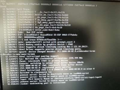

    Unfortunately no success again. All kinds of error messages (see attached), like "error_code+0x67/0x6c". I have seen that same error before.
    I have searched the internet for the meaning of that error message, but apart from finding a lot of options and people giving up, I haven't found out how to fix it yet.

    Do you have the bio's set to boot from dvd/cd to boot First ? your file is too hard to read.. I cannot see you file close enough to read the errors.

    Ah Yea !! To me is looks like you have Mixed errors on your screen some Linux and some Windows.. At this Point, I would just Wipe the entire hard drive and install Windows back... What are the specks of this computer ?
