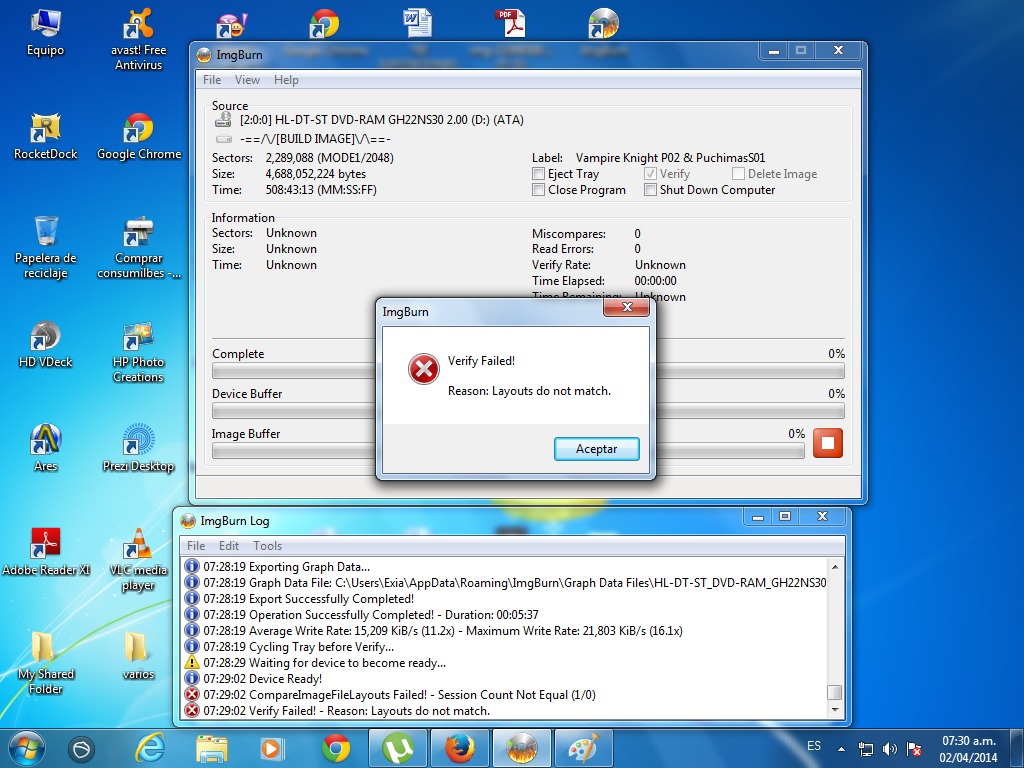

    Hi,
    I'm new here and it's my first post and this is my problem:
    When i'm burning a dvd i don't have any problem and complete the process sucessfully but when i put the recently burned dvd the wirter read it's like a blank dvd and i prooved the burned dvd in a friends house and can read the dvd it's somebody can help me i'll be grateful.

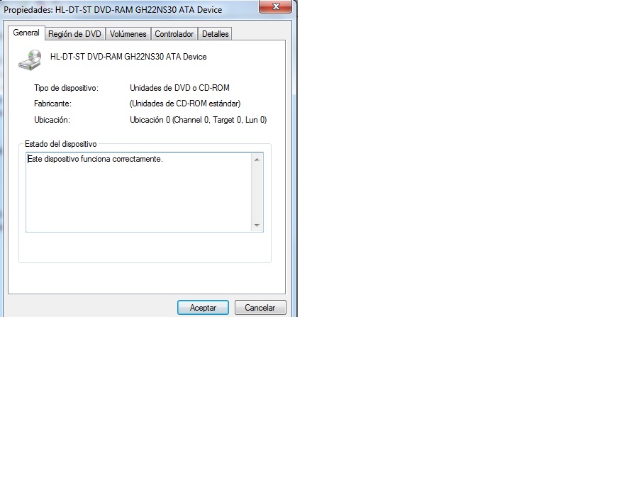

    And i checked the dispotives manager and appear the dvd-writer it's ok, it doesn't appear a problem. quemador info.jpg Problema quemador.jpg

    IMGBurn version? Try latest.
    Write speed was? Try slower speed.
  3. light_zero004

  4. Wicked Mystic
    Wicked Mystic Big Geek
    53
    28
    Try slower then.

  6. light_zero004
    light_zero004 Geek Trainee
    I'd already try with Nero, Img Burn and CD burner and give me the same problem i even re-instalated the driver and still happens.

  8. light_zero004
    It's a remenber well a litle more than 3 years, but that's the odd part because in the devices manager appear it's working corrrectly but today or tomorrow i will buy a new one.
  9. Wicked Mystic
    53
    28
    Device manager only tells if it can connect device and get no error codes. Not that device is really working.
  10. light_zero004
    In other words my burner is a living dead and thank's i already made my mind that a have to buy a new one.
