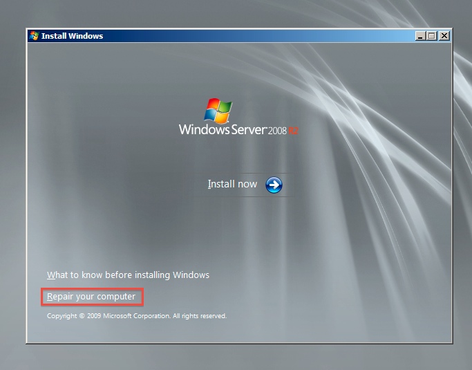

    Note for Windows Vista and Windows 7
    The original registry files in Windows Vista and Windows 7 are located in a different folder: WINDOWS\system32\config\RegBack
    Instead of using the Recovery Console, insert your Windows disc and launch Setup. Choose Repair your Computer instead of Install Now.
    Choose your current Windows installation and then choose Command Prompt.
    In this example I'll restore the Registry file 'system'.
    1. Backup your original file.
    Code:
    cd C:\Windows\system32\config
    ren system system.old
    2. Restore the original file.
    Code:
    cd C:\windows\system32\config\RegBack
    copy system ..\system
    You can now reboot your system.
