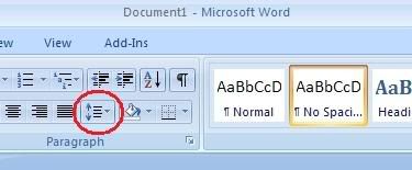

    In MSO 2007 word can someone please explain to me how when i open word i can set it to no spacing as default ? it keeps opening at normal, i keep going through the settings but cant seem to set this fetcher :O any advice appreciated thank you :)

    Click on the button that I marked above.
    Now a list should appear. First click on 1.0.
    Then click the marked button again, and now at the end of the list, there should be a button with Remove in the sentence. Then repeat this step.
    Now click the marked button again, and click on Options. A dialogue box should appear. Mark the checkbox at the bottom of the dialogue box, and click on OK. Now go back to Options, and click on Default (or Set as default). then click on Yes and OK.

    DONE IT ! Roy your brilliant !!! ( Big Kiss) MS Word now opens in No Spacing :D :D :D
