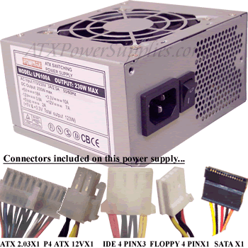

    The other day I bought the wrong PSU for my dell dimension 4400. PSU which I bought looks like
    and the specifications which I have about this PSU is

    But I was looking for a 20 + 4 pin PSU and this PSU doesnt have a 4 pin plug. I am just confirming if there is any wire extension which I can use to make this PSU work like 20+4 pin PSU.
    Thanks
