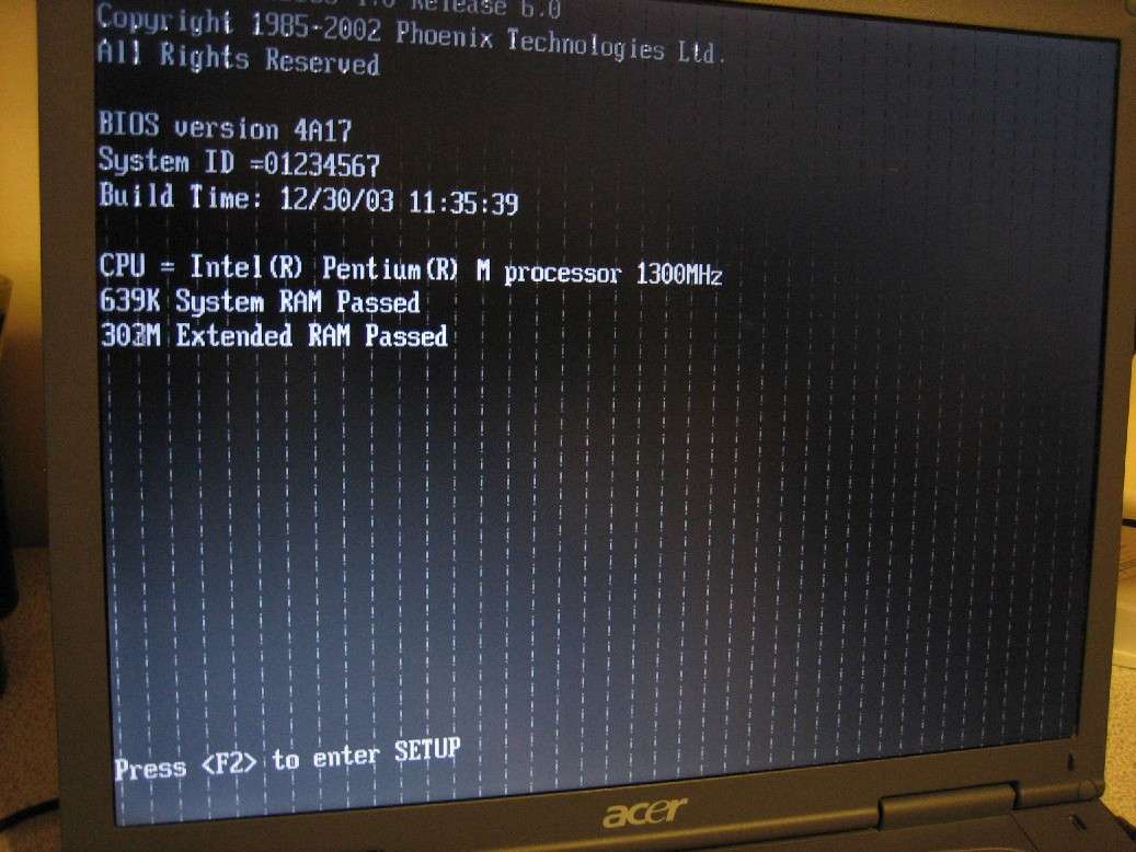

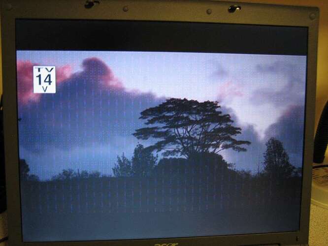

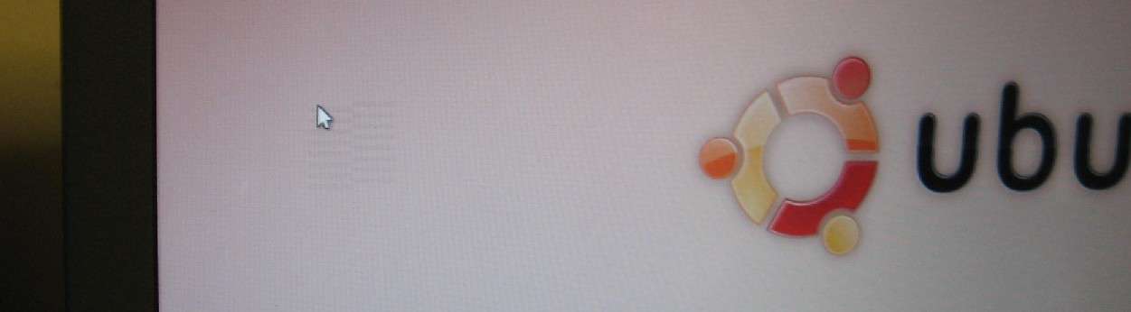

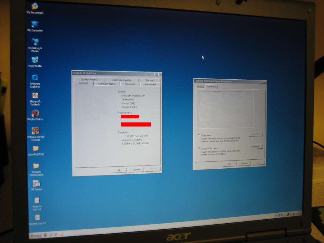

As I said the problem is graphics corruption. It is hardware related because it occurs at BIOS level (see 1.jpg and 2.jpg), and in multiple operating systems (Ubuntu and Windows). Have a look at 3.jpg which is the start screen of Windows. A similar thing happens for the Ubuntu splash screen but it is less harsh and so the photo did not show it very well, hence it is not attached. As it happens in multiple operating systems and at BIOS level it cannot be driver related. I also believe it is not the cable that connects the graphics adapter to the LCD monitor due to 5.jpg which shows the System Properties and Taskbar Properties in Windows – both of which should have pictures but do not! Also notice 4.jpg which shows graphical corruption around the mouse pointer in Ubuntu.

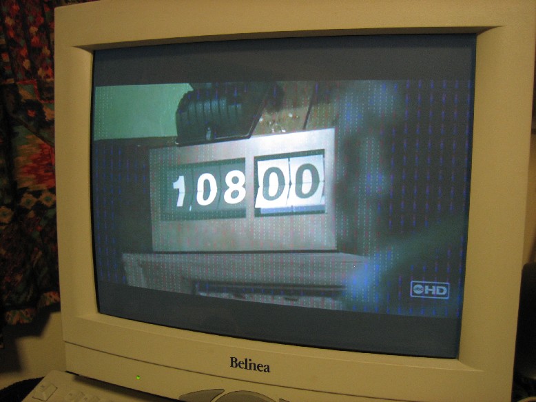

I could live with these defects to be honest. But when I watch movies on my laptop (using either Windows or Ubuntu) I get nasty lines down the screen resulting in an unwatchable picture – see 6.jpg for an example.
As I said the issue is hardware related. I have tried changing my system BIOS to other ones available on your site but none change the issue. None change the VGA BIOS version which is stuck at ATI M9 008.006.009. Is there a problem with this VGA BIOS? If not what is the issue? When at BIOS time with the Acer screen disabled (FastBoot I think) it has corruption until it says Video BIOS Shadowed (or something like that – it disappears pretty quickly!) then the corruption stops for a few seconds and then returns again.

First of all check it with a external Monitor to make sure that if its a graphics card problem or Notebook Screen… Other than that, it doesnt looks like any drivers problem or so as u stated in your email.
That’s a good idea. Hadn’t thought of that. Will try tomorrow and see. Still no reply from Acer…
Acer got back to me with a shocking deal! Have to pay £40 just to have it diagnosed and no doubt some huge cost to have it repaired. Its not worth it!
I tried it with an external monitor and had exactly the same issue (see photos). I’m assuming that means the graphics adapter in the laptop is not working. I saw a broken TravelMate 800 on eBay claiming that the graphics adapter had completely failed, but the rest was working. Is the Mobility Radeon 9000 easily broken or is it something Acer put in there?
