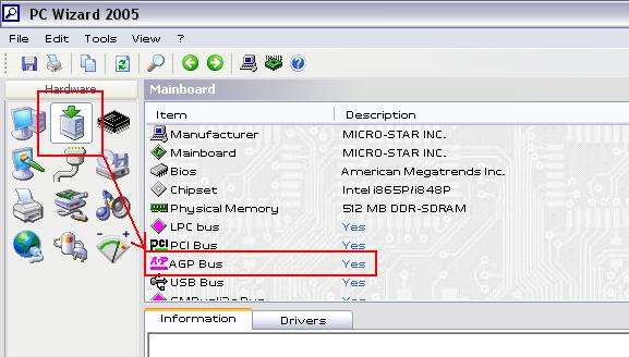

Ok, i opened up my comp and found out that i have 3 slots (FX5200 is fitted in one of these) and a seperate orange coloured slot which is diffrently positioned from the other 3 slots… will my GTO fit in there?
That slot is probably AGP, what is your Motherboard model, if the GTO is AGP then it will go in there, if it’s PCI-e then you’ll need a new motherboard.
AMD Athlon 64 3400+
That’s your CPU, what about your Motherboard, download PC Wizard 2005 and then click on the icon on the left hand side that looks like a computer tower with a Green Arrow pointing to it, this will tell you your ‘Mainboard’ Information (the icon is the middle on the first row)
Tell us if it tells you that your Motherboard has an ‘AGP Bus’
Also where did you get your graphics card from, is it PCI-e or AGP.
I have attached an image of what to look for in PC Wizard, if it doesnt have AGP but has PCI-e then you’ll need a PCI-e Graphics Card, if it does say AGP then you’ll need an AGP Graphics Card.
http://photobucket.com/albums/a54/dod99/?action=view&current=Comp.jpg
Okay then that different coloured slot that is in a slightly different position is AGP, now what card did you order, AGP or PCI-e? Have you go the link to where you bought it from?

Then it won’t fit, you’ll either need a new motherboard with PCI-e slots or you’ll have to get the AGP card.
See if you can exchange the card for an AGP version first…unless you’re planning to jump to a motherboard with PCIe…
