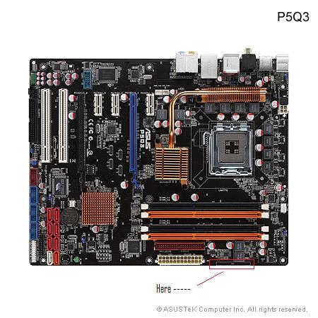

When I plugged in the power supply and attempted to run it, some copper completely broke open between the main power connector and a copper wound coil in a plastic casing.
It seems to have protected the rest of the board, but I am not sure if I can solder or re-connect this broken copper (it appeared to actually burst out of the PCB board).

Sounds like something on the motherboard burned or broke off? Please post a pic of a similar motherboard and tell us where and what.
Ok here is a picture of the actual motherboard model (not the one that is broken, but an identical product).
Now I understand it. Copper track on PCB which connects power plug to a copper coil on the mobo got burned?
Yea, that can be repaired, just substitute a good thick wire for the PCB track. But, because PCB copper track burned, this is an indication there is something wrong there. Most likely other parts are burned as well. Thus, you need a professional with tools to diagnose and repair this board.

It appears to be motherboard problem. A short on the motherboard caused PCB copper track to melt along with something else as well.
