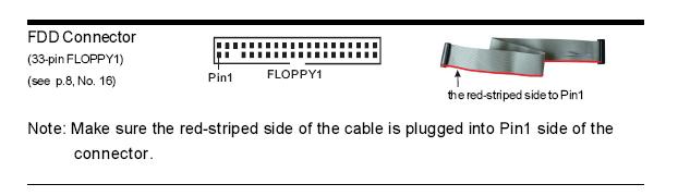

On the other hand, my floppy drive hasn’t been working properly for a while, it’s being recognized by windows and is visible in “My computer” and in BIOS even the light is working on the device itself, putting any floppys in results in nothing, I can’t read them no matter what I do. I never bother looking into it, because I never use the darn thing though.
If the floppy’s light is on constantly it could be because you connected it the wrong way… maybe that is why it will not read anything?
I was thinking the same too, have to check on that later now I got the advice from a more experienced person, because the light is on constantly.

See if the attached image helps.
