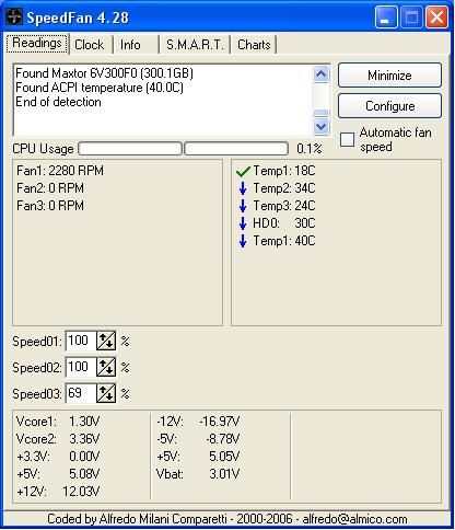

Download and install SpeedFan and post a screen shot of your PC if you can, if not then just report the temps it’s giving to us.

We haven’t established that it’s overheating yet. That’s why I gave the link to SpeedFan as after looking at that we can get an idea of temps. Also ceales could you post the temperature of your graphics card? You usually find this by view the nView program (or at least I do, I’m not sure with your card and system though…)
I have one fan on the mother board it is a sanyo denki, I have been to the sanyodenki site but its not very good and does not recognise my poart number I have attached a pic of speed fan results
fan 1 is at 2280 rpm
fan 2 and 3 are at 0
just got this up !!??
