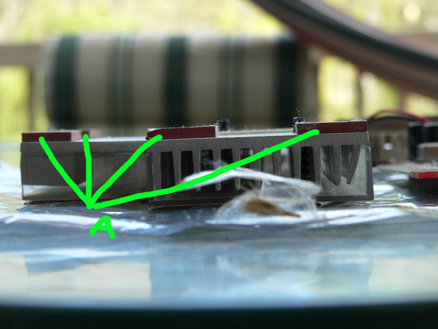

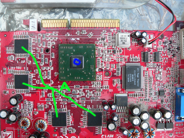

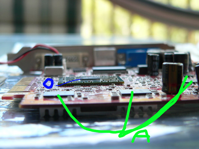

I took the heatsink off the card and found it had quite a thick termal pad. I pulled this off and applied a thin layer or thermal paste on the core. I put the heatsink on and then pulled it off again to make sure it was touching the heatsink. It wasn’t! in the end i ended having to put a quite thick layer of paste on for it to get to the heatsink.
The heatsink has like sticky pads on the sides, about five which stick on to different chips around the card. I didnt bother with these because they didnt look like thermal compund. I think this is what is rasing the vard to high.

Here are some pics. I have labled the thick thermal pads as “A” and the core as “O”.

Those sticky pads on the edges of the heatsink are infact Thermal pads, to cool the RAM chips. It’s possible that too much heat may cause the pads to expand confirming what you suspect, but unlikely.
It’s usually safe to remove the thermal pads as the 9600XT doesn’t output much heat and is generally a cool running card.
I think you should ideally invest in another heatsink for your card. Perhaps a *sink from the Arctic Cooling range (ATi Silencer) or a Zalman VF700 copper.
In the meantime there’s nothing else i’d suggest or can think of but giving the heatsink and the card a good clean out of dust ( i noticed the capacators has dust caked around them) and reapplying a thin layer of TIM.
