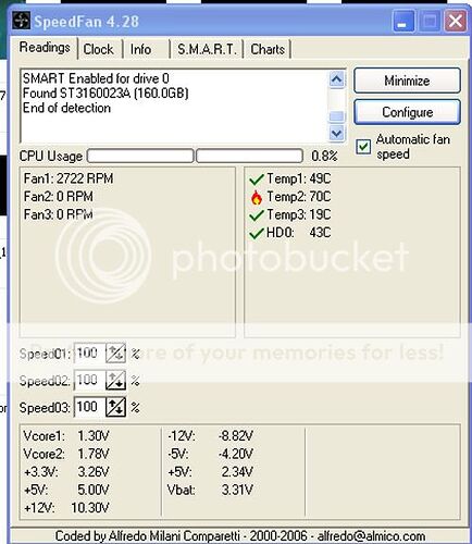

However there is something im concerned about. I took a screen capture of SpeedFan.
As you can see TEMP 2 is high, how can I find out what each TEMP reading is located at?
I dont know much about HT CPUs, but would it be possible to have a different temperature reading for each of the two virtual CPUs (Dont know the proper term, is each CPU called a Thread?)
Anyway, in accordance with that higher temperature reading at the bottom you can see that the Vcore2 reading is putting more voltage.
Lastly, the voltage readings. The +12V seems to be a decent percantage lower, and in the second column the +5V is less than half of what it should be. It dont see how that could be the case cause in the first column the +5V reads ok.
How accurate is this information from this program?
Looks like it might be the PSU. The upped voltage could up the temperature, although I’m not sure if that is the temperature of the CPU or the PWM.
10.5V is way out of tolerance for the 12V rail. Wether the computer is too much for what you got or simply a poor unit, I’m not sure.
Newegg has the FSP AX400-PN (400W) for $40 and the AX450-PN for $50, and they have some very nice specs on them, especially considering the high quality and prices they’re going for.
49C is getting warm, but you might want to find out where the 70C is coming from as that’s definitely a problem. If you feel your heatsink is warm, then it’s probably attached correctly. If not, you’ll want to take it off and install it correctly. You may also want to get a can of compressed air and blow out the system while you’re in there.
Thanks for the replies again.
My CPU is a prescott, and from reading on here these guys run quite warm. It registed 28C when I woke this morning, and after 4 hours of DVD playback on my front projection system, it climbed to 59*C. When I run HD content for longer periods of time it gets in the mid 60’s.
That high reading temp 2, I have no clue what it is. I installed MBM 5, and it only has 1 temperature reading for my motherboard. And that one temperature reading is displayed as CPU temp in that application. It also is the exact same reading that Im getting with the SpeedFan program for Temp1.
I have a name brand PSU that I bought from Circuit City about 1 year ago, for an older PC that hasnt gotten much usage. So Im gonna throw that in this PC to see if I clean up that 12V rail some.
