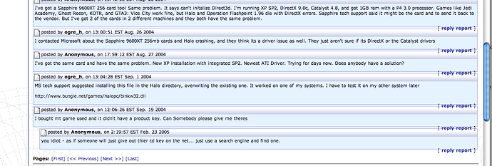

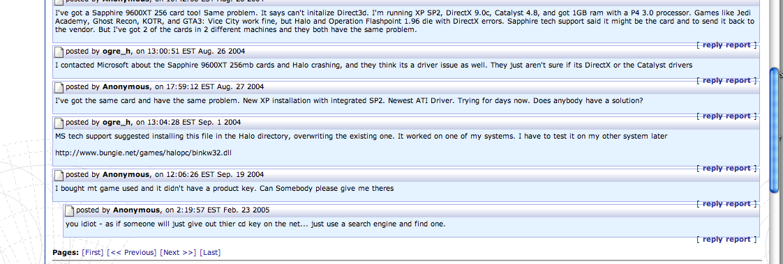

I figured it out!!!
If you try searching for Halo + Direct3D on google, you’ll get a mountain for forum posts with people having my exact same problem.
The solution turned out to be very easy.
See the attached pic. All I did was download the small file and replace with the file in the Halo directory.
That’s it. Nothing more.
