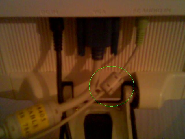

Hmm maybe one thing to note (perhaps irrelevant) is that the audio cable that came with the monitor has thing on the other end of it between the ends. Sorry, I wish I knew the english word for it but it looks like special cable because of that…
Could you maybe post a picture pointing this ‘thing’ out?
[QUOTE=Matt555]
Will do, here:
http://www.hardwareforums.com/attachment.php?attachmentid=1049&stc=1&d=1148407154
What do you think?
That’s nothing to worry about (I think, I never did find out what that was all about…)
It shouldn’t change anything, I’m really not sure what’s going on:
