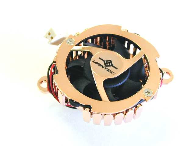

I love ABIT boards, and I use them almost exclusively for high-end workstations. Having said that, their northbridge fans suck! They are sleeve bearing, and really don’t last very long*. Now, I preemptively install Vantec Iceburq [Newegg.com] chipset cooling kits on all the ABIT boards I deploy. They’re copper, ball-bearing, and they’ve worked really well for me. Even if you just need the northbridge cooler, it’s nice to have the whole kit. It’s under $10, and since modern southbridge chipsets tend to get quite hot, you’ll get some use out of it.

Thanks for the feedback… Is this Vantec fan perfectly compatible with the NF7? (ie: do the holes match up?). If so i have no hesitation buying it. I love abit boards as well and am dissapointed that I have to be dissapointed by their poor quality fan.
Is this it? http://computeravenue.mywinnipeg.com/proddetails.php?lngProdID=1568
Yeah thats it! The holes will match up! Every ATX compliant northbridge cooler should
take care
That’s the one! And as for the size, yes, it’s identical, so it should work perfectly for you. Unfortunately, you’ll have to unmount your motherboard to change it out, but it’s definately worth it to protect your investment. Just clean off the gob of white silicon that’s already on the northbridge, add a BB-sized bead of Arctic Silver and spread it evenly across the surface. Add the heatsync firmly, and remount your motherboard. Viola!

Thanks a lot man. I am dreading to remove the motherboard (so time consuming), but i know it must be done… As for the Arctic Silver. How is the stuff that comes with the fan? The stupid fan alone is $27 canadian and i don’t want to spend much more just for a stupid northbridge, lol…
It’s good to know that this fan is like the old one, just better quality… I don’t like making modifications to parts of the computer, i like it when it all fits well together… Thanks a lot for the help, i’ll buy one this weekend.
artic silver is a thermal compoud purchased seperately, high grade. Thermal compoud comes with the cooler, but is of a medium grade and will not cool as effectively. Arctic siler will drop the temps of your northbridge from 2-6 degrees! but at a price my friend
