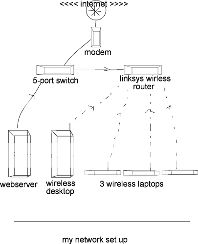

sorry for posting 3 times in a row on my own post, but i didnt want to edit the giant, previous post because of its size…
heres an outline of my network, hope this helps…
Hmm, a bit of info for you. Your IP configured in Apache (ServerName 172.18.128.1:80) looks like your gateway, not your actual IP. That IP is one of your hops on the way out; it can’t be your Apache server unless you were doing PAT on that system (judging by your diagram, you’re not). Also, your webserver’s alias address is within 172.16/12 , which means it is private. Another router upstream of you is performing NAT. Actually, there are a few private hops between you and the internet.
The bottom line here is that the way your ISP is setup, it appears that you cannot host any services at all. It’s simply not possible based on the info here. If your ISP wants to give you a public IP, that’ll be the only way to host anything across the Internet. Sorry.
thanks, though not the ending i wanted… FINALY A CONCLUSION!
