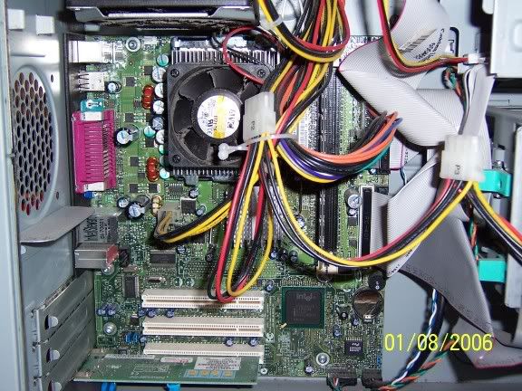

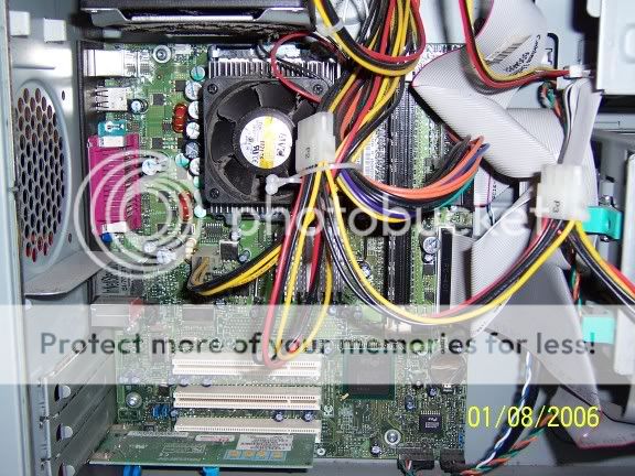

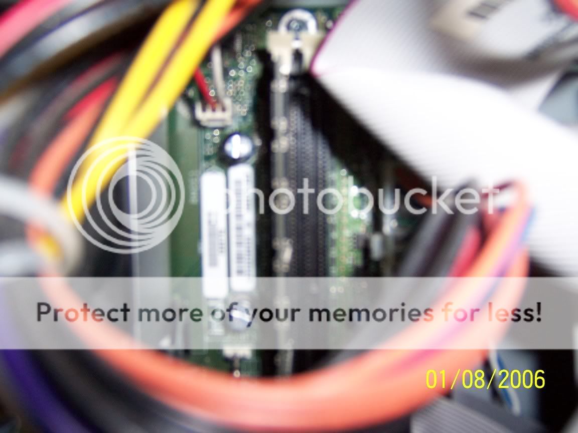

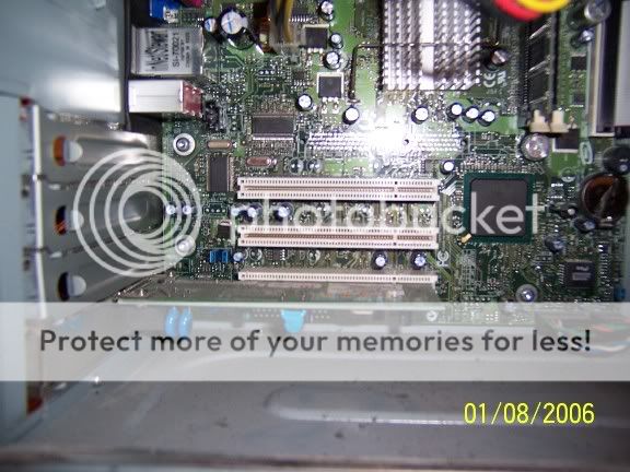

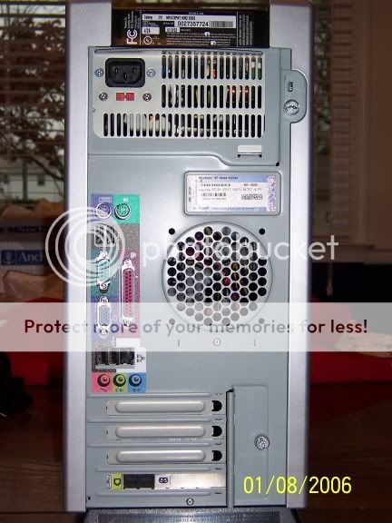

i Have 4 140GB 10,000 rpm drives and 3 73gb 10,000 drives i plan on using 3 or 4 of the drives but my motherboard doesnt have scsi ports are there any converters or adapters?
btw i dont know nothing about SCSI these drives are new and were gave to me

It’s not the newest thing out there, but for starters, the Tekram DC-390U2B or DC-390U2W (has a few more features) are pretty good, and use regular PCI slots (not PCI-X slots found on server boards).
