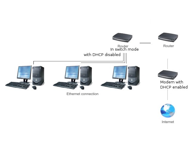

@RH: the 3 routers are all connected to the modem
thomas, this would be much easier if you used a single router & 2 switches & it would be much cheaper
however, if you connect only 1 router to the modem & disable DHCP on the other 2 routers, this effectively converts a router into a switch
Edit: effectively making your notwork topology look something like the attatchment

ok, what you / they have is an Huawei Echolife 520s - wireless router & 2 switches, i’ll get GIMPing your network topological diagram
BTW: it would take me hours because i don’t fully understand networking, so, bear with me please, but a network expert like AT wouldn’t take that long
the only reason i don’t fully understand networking is: i only have my single home system to play with & only have other forums & wiki to rely on, but, i’m always learning & willing to try new stuff, anyway, i’ll get started with GIMP
http://img501.imageshack.us/img501/1175/thomastopologyzz6.jpg
it’s not brilliant but you get the idea
BTW: the switches are actually routers with DHCP disabled, one 1 DHCP server should be active
the only active DHCP server, i think, should be the router connected directly to the net :unsure:
and the wireless i can’t comment cos i’ve never seen or used wireless, but, then again, i’ve never setup a network, so, i don’t know how i know :cool:
Edit: all cabling is CAT 5 U/S TP Ethernet

well i wouldn’t say that, i didn’t even use the correct symbols, but, like i said, you get the idea
it’s actually your original pic with a few bits cut off & some other bits pasted on
your more than welcome BTW: it’s actually my first attempt at a network topology diagram & i’m pleased / glad you like it
turn DHCP on on the router connected directly to the net because if the router has DHCP on it acts like a switch whereas with DHCP on it will fully enable the router, then it may just work
Edit: if it works, it is because enable or disabling DHCP (very basically) turn routing on or off, obviously it does far more than that, but try it first
Edit:
yes, becaus it was acting like a switch, enable DHCP & it should act like a router
