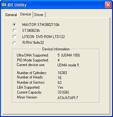

I’ve updated the bios, but with no success. The size of the hard drive is still 33 GB. Here is a screenshot of an IDE diagnostics program about this harddrive:
How long have you had this HDD for? have you actually touched the jumpers on it at all or even looked at them?
This HDD is about 1 month old. I’ve set the jumper to master (according to the image on the sticker of the HDD) on the old motherboard. After I connected it to the new motherboard (without touching the jumpers anymore), the disc was suddely 33 GB in size (and not 80 GB anymore).
