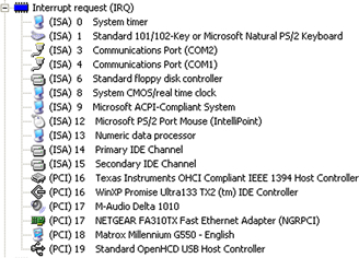

I tried reinstalling the drivers but that didn’t seem to work. I’m attaching my IRQ list. USB controller is on its own IRQ but I see two instances of sharing. Not sure if that contributes to my problem. I’ve added my system specs to my signature.

As for your IRQ’s, I unfortunately do not no much about them. Sorry about that, I feel like I set you up on a hook and left you hangin…hopefully someone else knows something about IRQ’s.
