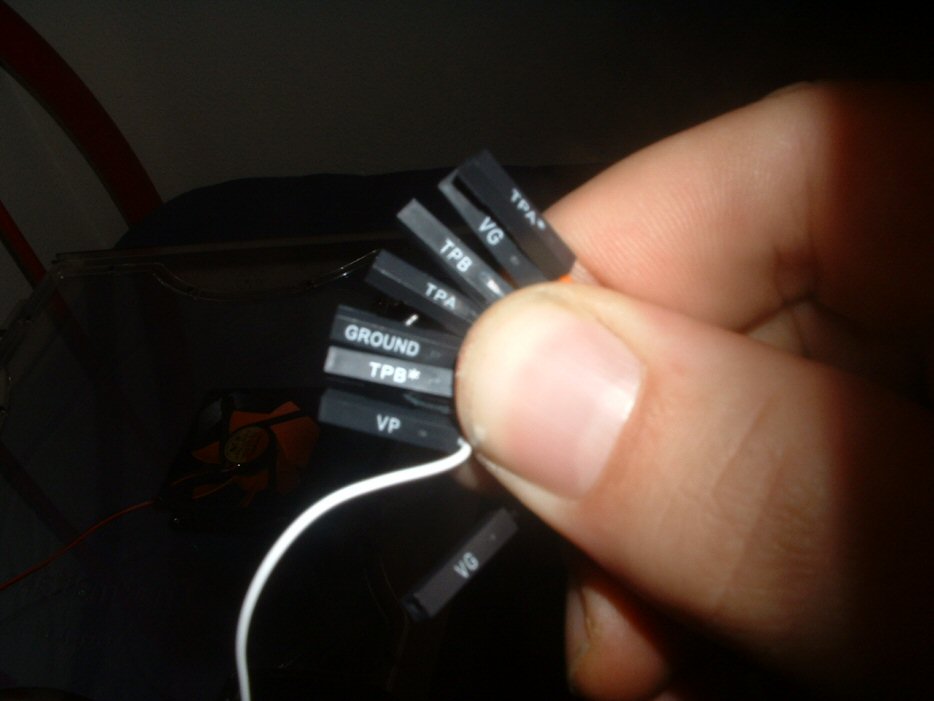

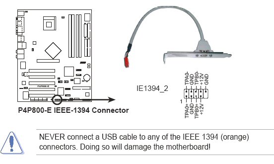

can somebody tell me which wire goes to which header, i think i know all of them except the wires that go to the 12v header. thx
please take a look at the following pictures
This is how I think it seems to work out:
Header — Case wires
TPA* ---- TPA0+
TPA ---- TPA0-
TPB* ---- TPB0+
TPB ---- TPB0-
VG ----- GND
VG ----- GND
VP ----- GND
Ground --GND
Now, I realize that one of the 4 grounds isn’t going to be able to connect to anything, but that’s fine. As long as there is a ground wire, you’ll be alright. You might want to contact Asus about it as well to be sure, although I’ve not heard the best things about them.
