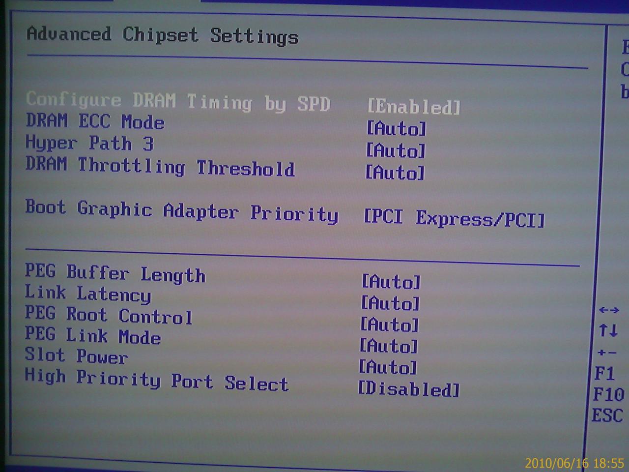

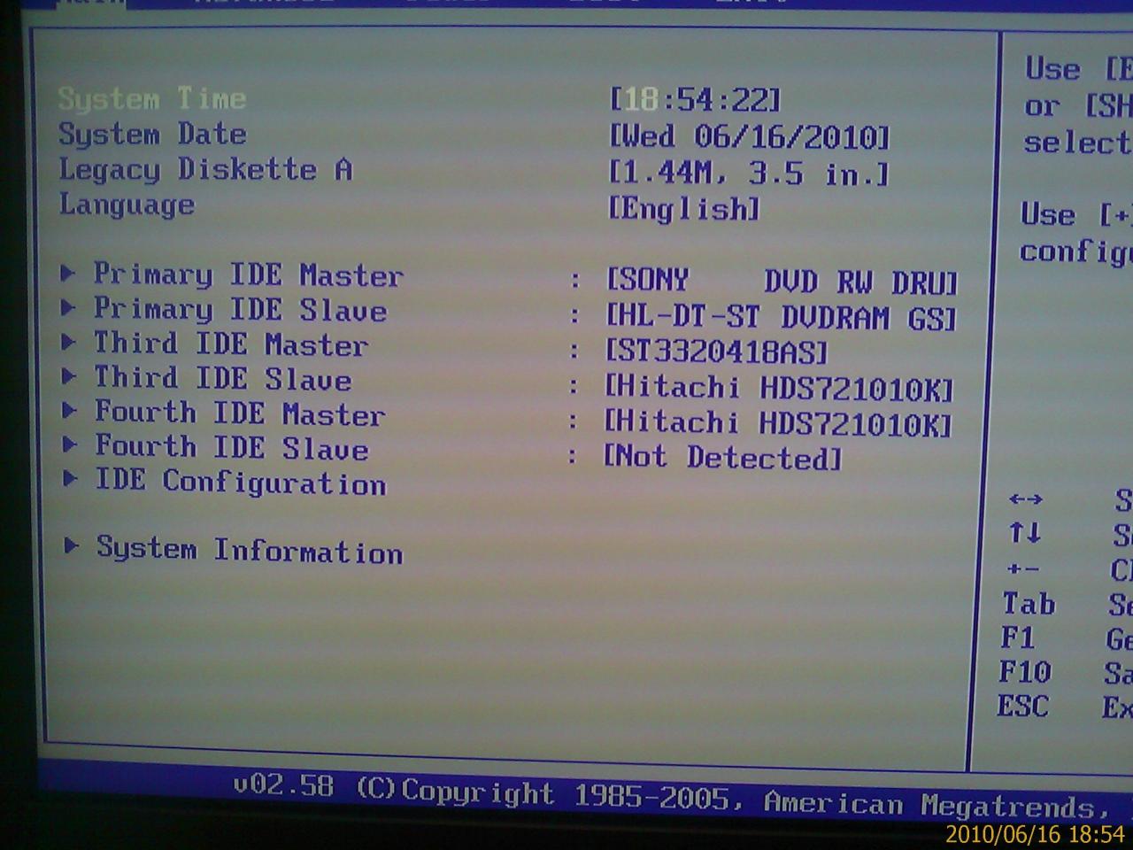

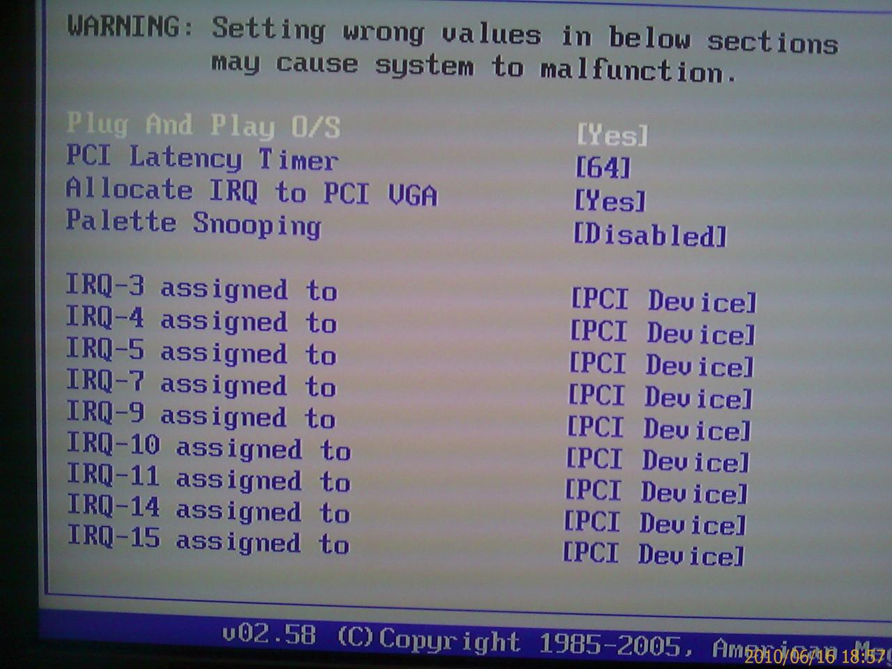

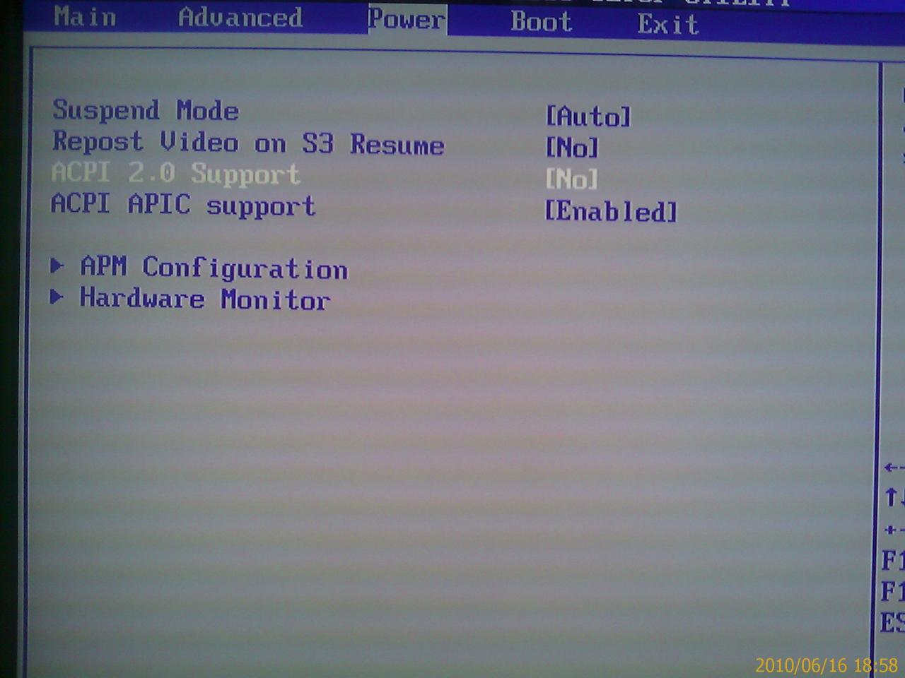

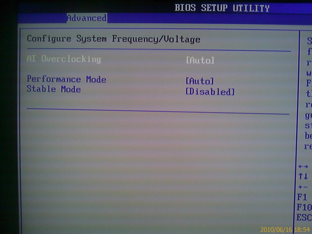

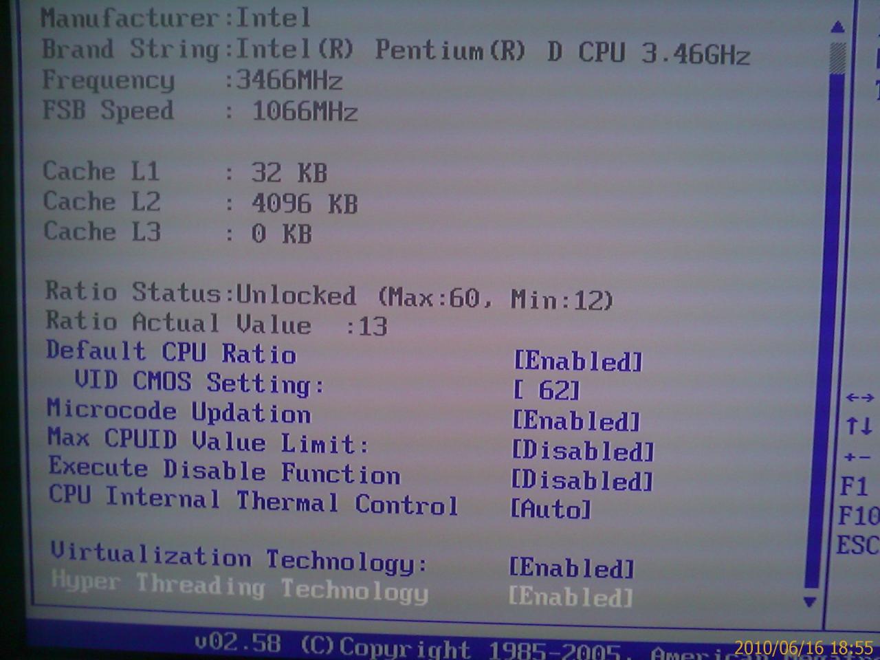

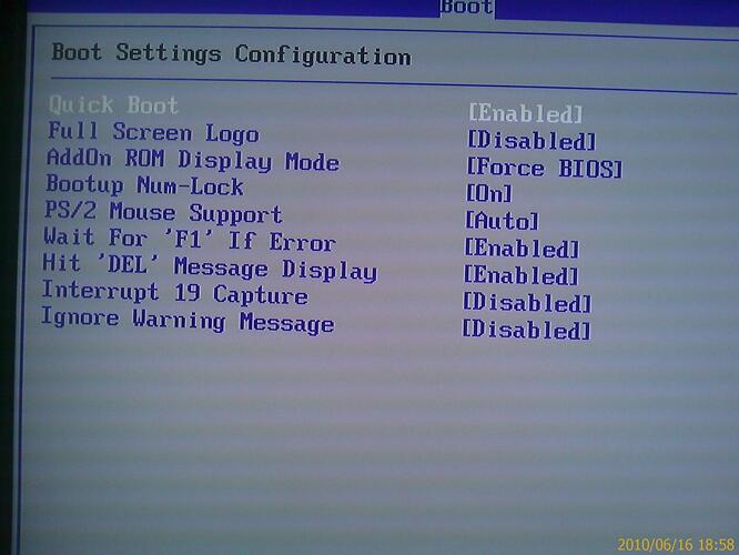

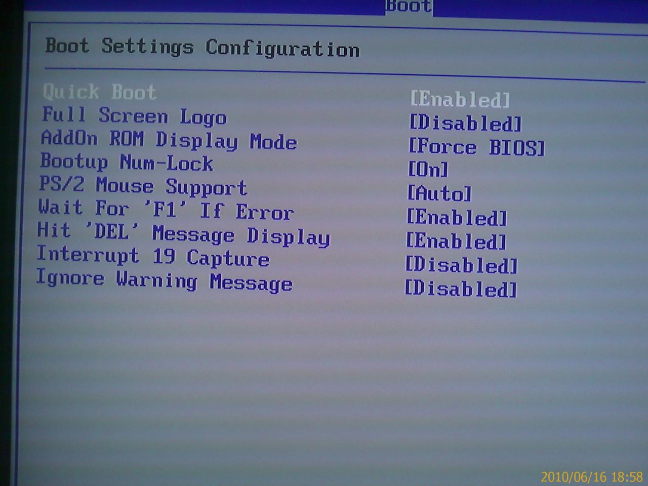

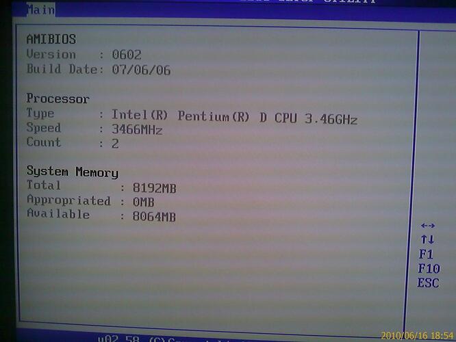

When I install the 8400GS and I try to boot into windows, the system just hangs on the Starting Windows screen. Nothing else happens. I messed around with settings in the BIOS to see if it was some kind of resource confilct, but nothing helped. You can take a look at most of the settings as they are now here or in the attachments:
Is there something that I am missing? Is my PSU powerful enough? I really don’t know what to try next… any help would be greatly appreciated.
