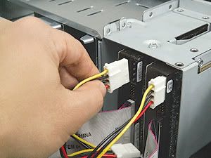

  1. Open the case of the PC.
  2. Locate the hard disk that contains a bootable partition.
  3. Pull out the molex power cable from the hard disk.
    http://i164.photobucket.com/albums/u7/RHochstenbach/tutorials/step7c_300.jpg
  4. Turn on the computer, and wait for the CD to load. You should see the message “Setup is inspecting your current hardware configuration”. Then plug the molex plug back into the hard drive (keep the computer turned on). During the loading progress, the USB drivers get loaded too. Then you will be able to use your keyboard, and continue with the rest of the installation.

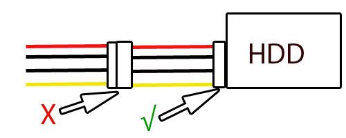

[li]Unplug the cable from the drive itself, and not at a molex extension. This because the plugs that connect 2 molex cables could short-circuit the cables when powered on.[/li]http://i164.photobucket.com/albums/u7/RHochstenbach/tutorials/HDD_MOLEX.jpg
[li]Make sure that you plug the molex connector back into the correct position (not upside down).[/li]
