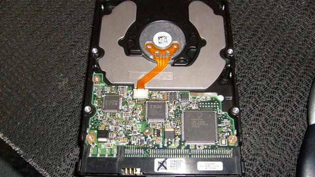

I’m attaching close up pictures of the label and the PCB.

probably the easiest way to replace the logic board is to buy an identical HDD and swap the logic board from that HDD
what happened anyway, and what is the HDD doing now & how do you know the logic board has failed
Thanks for your reply.
Well, I posted here because I have tried all over the Internet already to buy a drive exactly like mine, but since it’s a 2003 drive no one carries it now.
My drive with is original board does not turn on.
I bought two other drives on eBay, VERY similar to mine but not 100% the same, they both are 80.0GB EXACT capacity not 80.4GB (those have been the closest drives I’ve been able to find), and although the drive turns on now my PC doesn’t recognize it either. I tried it as a slave on an IDE port and in my USB case and it doesn’t get recognized by Windows.
I tested my USB case with a drive that works inside my PC and Windows immediately recognizes it.
I fixed my drive, I replaced the PCB and it worked perfectly :smiley:
So the things I learned that needed to be considered when finding this new drive I were:
  • Brand (duh)
  • MLC: H69205
  • P/N: 07N9685
  • Model Number: IC35L090AVV207-0
  • EXACT Capacity: 80.4GB (80.0 nor 82.3 would work, it HAS to be 80.4)
These 5 characteristics need to match, otherwise the PCBs you use won’t work.
Thanks to all,
Zuertex
