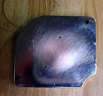

Btw, temps went down from 48C idle (73C on die) with the stock hsf to 44C idle (58 on die).
I didn’t use 90% alcohol to clean the hs and die, I only had 70% alcohol.

Yeah, it doesn’t take long to do, but you just wanna make sure there’s not a whole glob of goop on the core.
That’s what there was at the start, I redid it and the temps dropped by 5C
Yeah, it’s always best to clean off the CPU and reapply the thermal goop whenever you remove and/or change heatsinks.
