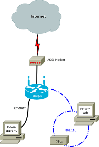

[strike]Does your ADSL modem have an ethernet port also, or just USB?[/strike] Nevermind, I think I understand what’s happening here. Give me a minute and I’ll diagram a proposed reconfiguration of your network. :slight_smile:
OK, so if I understand correctly what you’ve told us, the best setup for you would be something like the attached diagram:
[CENTER]http://www.hardwareforums.com/attachment.php?attachmentid=2013&stc=1&d=1231884992[/CENTER]
That way, the connection to the wireless router will not arbitrarily pass through the PC, so it will no longer need to be on in order for your wifi to work. Instead, you would be connecting the ADSL modem to the WAN port on the Linksys, the ethernet port on the PC to the LAN port of the Linksys, and the upstairs PC and Xbox would utilize the Wifi as usual. This should have the added benefit of speeding up your internet access to all PCs involved, since USB was never intended for networking use.
