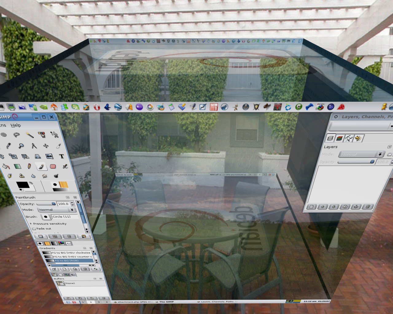

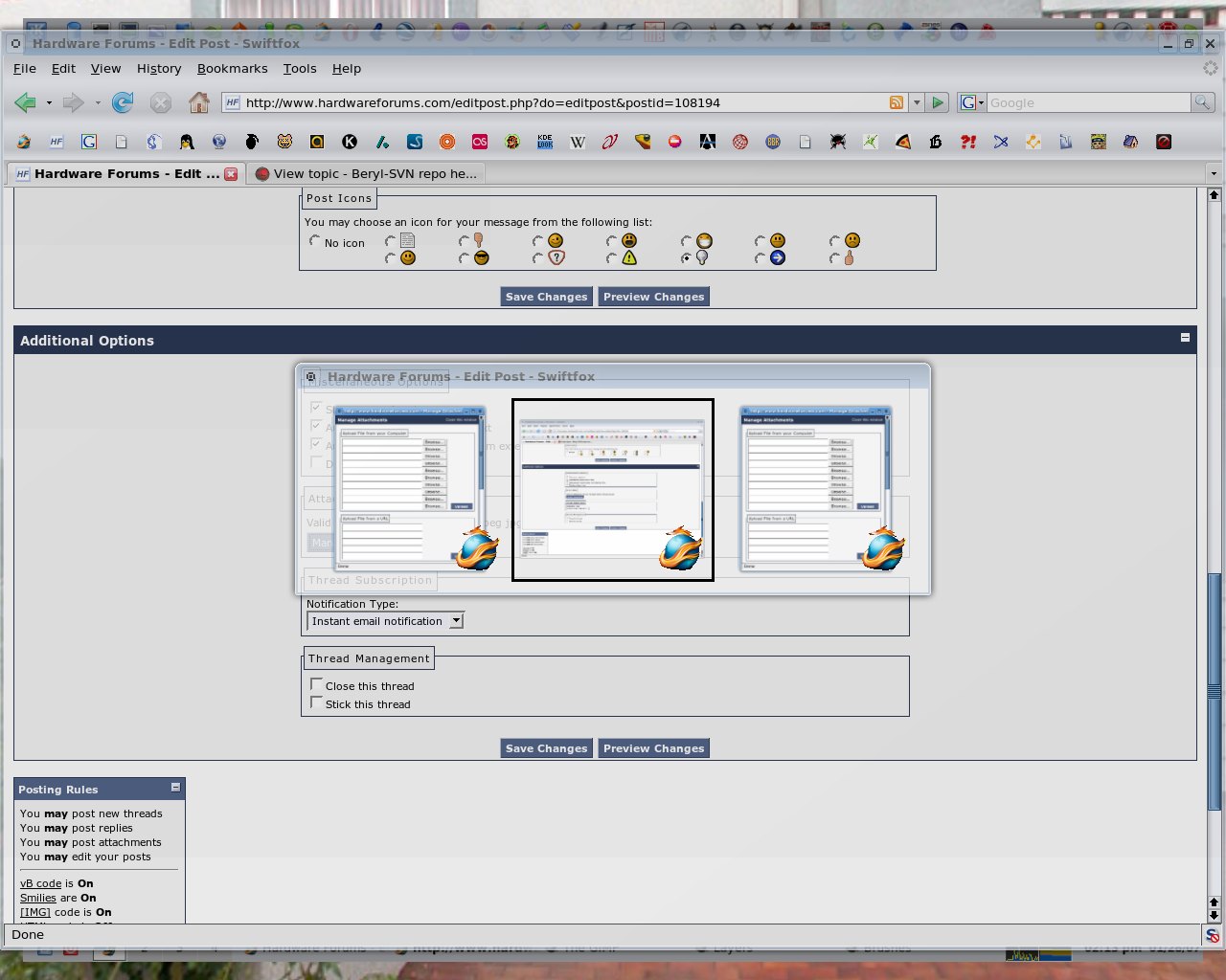

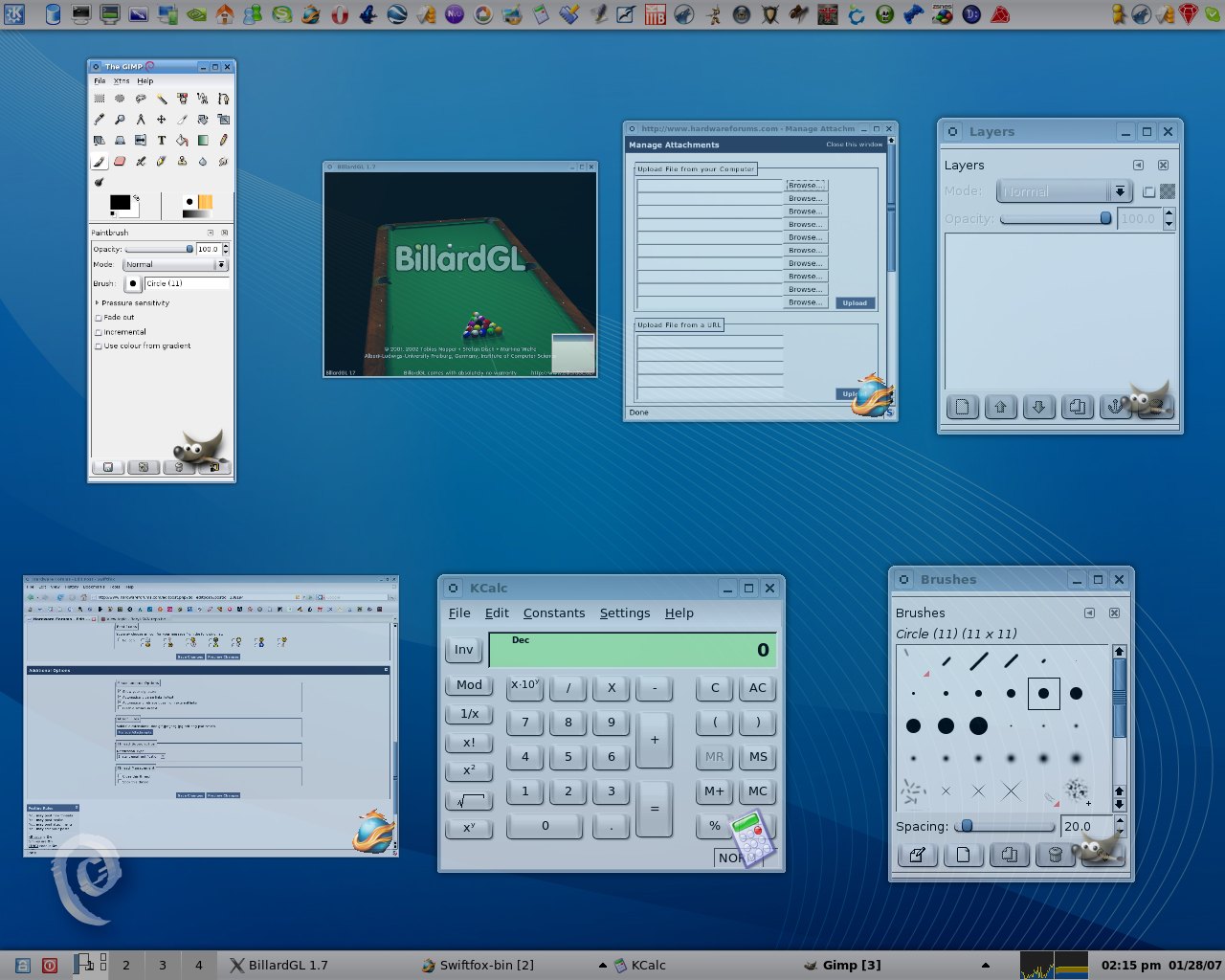

    Debian's "unstable" development branch, Sid, is an excellent platform for bleeding-edge development as well as having all of the latest toys right at your fingertips. Along that line of thought, the Beryl 3D window manager fits in nicely. Here's how to get AIGLX and Beryl running smoothly on Debian Sid.
    1. Make sure your 3D is working correctly and to full capacity. If you run the following command:
      Code:
      glxinfo | grep render
      ...you should get back something like the following:
      Code:
      direct rendering: Yes
      OpenGL renderer string: GeForce 6800 GT/AGP/SSE/3DNOW!
          GL_NVX_conditional_render, GL_SGIS_generate_mipmap, GL_SGIS_texture_lod,
      If you get back "direct rendering: No", you will need to get your 3D drivers installed and working correctly before you proceed. After all, a 3D desktop isn't much without working 3D! For NVidia users, this tutorial may help.
    2. Get your packages up to date. The easiest way to do this is of course with apt. Something like the following:
      Code:
      apt-get update && apt-get dist-upgrade
      If all goes as expected, you'll have all the latest packages Sid has to offer.
    3. Add the Beryl nightly build repository, then install Beryl. To do so, just follow the directions here: View topic - Beryl-SVN repo here :: sidux.com :: debian based live cd development
    4. Start Beryl with the 'beryl-manager' tool.
    5. Enjoy your next-gen 3D desktop!
