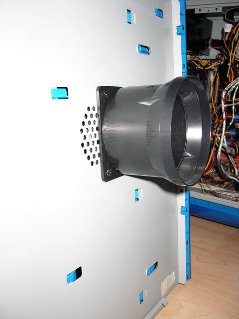

    I attached some pictures of what the inside looks like, the airduct can't be taken off without force.
    I'm afraid I might break it, not that it's going to make much of a difference without it, that duct directs the air into my cpu cooler. Won't installing a cpu cooler with fan on the side instead of a fan on top make it suck in hot air from inside the case??
    In that case I won't be buying the Titan Vanessa L-Type because it's fan located on the side of the device. If it won't make such a big difference I'll be buying that specific cooler.
    Any thought on this??

    It doesnt really make a ton of diffrence, the air inside the case is still colder than the Heatsink so it still cools it down
    BUT
    If your planning on doing high workloads with your computer (Encryption, Compression (and the reverse of both), High quality games etc) every little counts so you might want to turn that big fan (@ the bak of your case) around so that is it blowing air INTO your computer (might make the inside of you pc a little dusty tho)

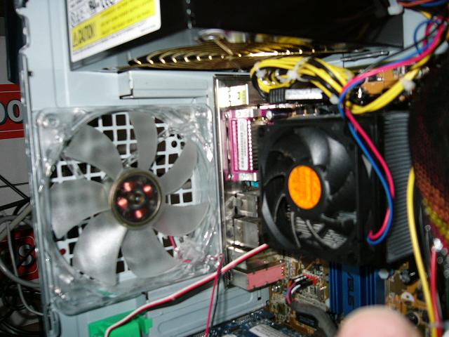

    I'm still not sure the best ones from the link in zRoCkIsAdDiCtInG's reply will fit into my case, I'm looking for a cooler which is low in height, with good performance, silent and one that doesn't require me to take out my entire mainboard.

    Anyhow, I got fed up with the noise produced from my computer so I bought the Zalman, it turned out to be the case fan on the back that made the most noise so I still have to replace that for a silent one.
    I overclocked my cpu with 10% and now it's running at 2680 Mhz, idle temps are around 45 degrees, is it any good? Can I keep myu cpu running at this speed?
