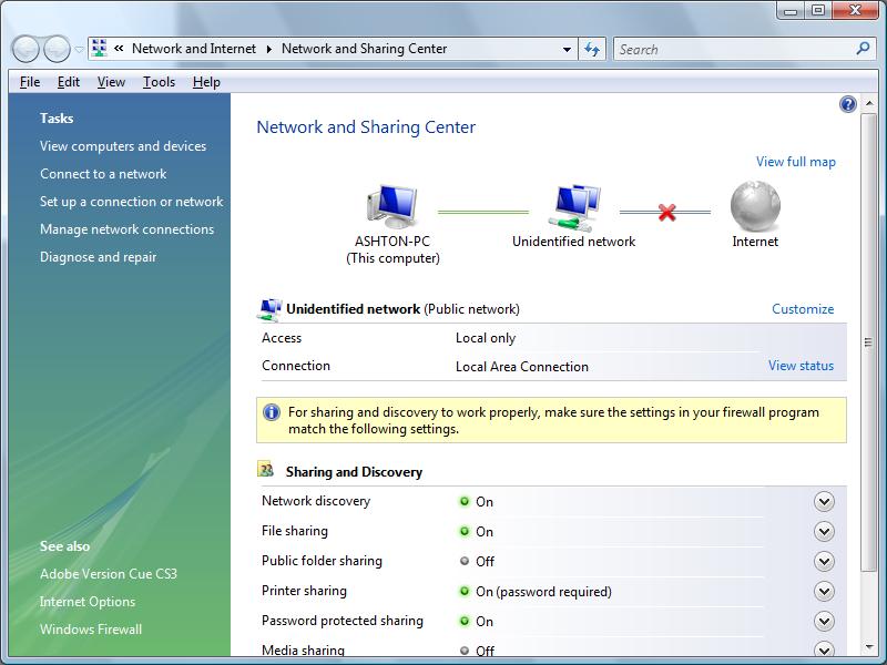

  3. Ashton
    Ashton Geek Trainee
    None at all, here is a screenshot of what my computer detects

  7. Ashton
    Ashton Geek Trainee
    I have windows live onecare installed on my pc and avg on the rest, but I don't think they're doing anything.
    sorry, can you explain how to run those commands?
