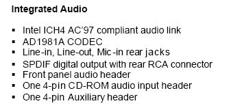

    Because of a goof-up on my part, I had to re-install XP SP2 :O now the sound won't work. (and other things)

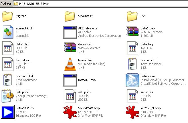

    I have downloaded the drivers from Tyan, file: 5.12.01.3513Tyan which is Sound Max,(4th pix). I took a look at the specs and I saw that it was a (2nd pix) AC '97 compliant audio.

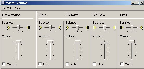

    Anyway at first I installed the Sound Max program/drivers and the sound didn't work. Made sure all volumes were up high and on - nothing muted- checked in system/hardware/device to make sure that there were no yellow ?. So then I switched drivers to add the AC '97 hoping that might work. Nothing :doh: :doh:

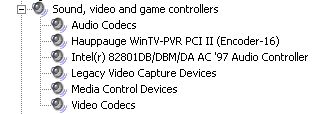

    This isn't meant as an insult or anything, I'm just not familiar with your level of technical knowledge: You have checked device manager to see if you're missing any drivers, right? If not, you can go to start -> right click My computer -> Manage then to device manager. In there, you can see if any drivers are having problems/not installed. Secondly, you can download and run unknown devices. When run, this program identifies the specifics of any hardware which is missing drivers.

    Fred,
    Thank you for looking and answering. Yes I have, In the last post there is a pix of the device mgr #3, no missing drivers/devices, sorry not labeled.
    Thanks for the link to unk devices, I'll uninstall the driver and run that.
