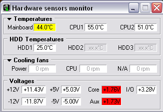

    I've got an Athlon XP 3000+ (333mhz version) CPU and MSI K7N2 Delta-L mobo. What's really strange is that my CPU becomes very unstable when the voltage is set to what it's suppost to be at (1.65v) and if the FSB is set to a correct 166. I can have the correct voltage if the FSB is set at 160. Naturally, I don't want this! At the moment, the voltage is set at 1.75v and 166 FSB. But the higher I put the voltage, the more stable it is. It's stable for regular use now but still crashes after 10 mins of gaming. Is it worth bumping it up even more? These are the temp readings I get (in the picture)
    I've heard that some mobos can't produce the amount of voltage that it's set to. Do you reckon that is a possibility?

    It's not that the motherboards can't provide that voltage, if anything todo with the motherboard it would perhaps be that the motherboards voltage settings in the bios were not calibrated accurately. However from looking at the image you provided i would say that your +12/-12V Voltage Rails seem slightly low.. although not low enough to cause the sort of problem you are having.
    First of all, i would check MSI's website and update your BIOS to the latest revision, this will ensure any possibilities of Voltage mis-calibration, then if you are having the same problem, try changing your powersupply for something more powerful (it's not about Wattage but about the Ampage).

    What CAS latency are you using? nForce 2 boards are known not to play well with a CAS setting of 3. You also may want to try running 1 stick of RAM at a time as well, and maybe bump up the DDR voltage a tad. There may be something that's getting stressed enough in gaming to start causing crashes. While those temps aren't the best (for stock speeds), they're not at a point where I'd see an issue.
    But, as ProcalX brought up, there's also the possibility that the power supply may be the problem. And, looking at the issue from the info given, I'm certainly leaning toward that as a possibility.
