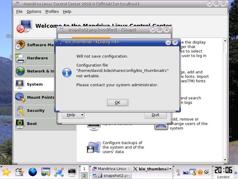

    Also, when now in Mandriva, I get the following error message in the attached screenshot. Any help would be greatly appreciated as I have not got a clue how to fix the problem.
