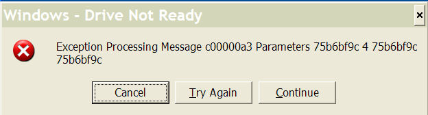

I tried one more time hooking up the devices in all the possible combinations. The conclusion is tha the DVD works well in any scenario. The hard drive is not detected in any scenario. If hooked up as master alone the computer hangs on "detecting drives" and will not boot. One oddity that I never say before was the "drive not ready" error at the conclusion of booting (see attached). I had to click "cancel." This did not happen when I disconnected my iPod. I will try the drive in my wife's computer next. IMHO the drive is a dud.
