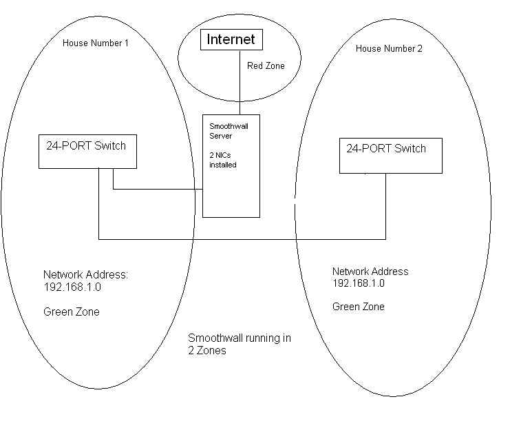

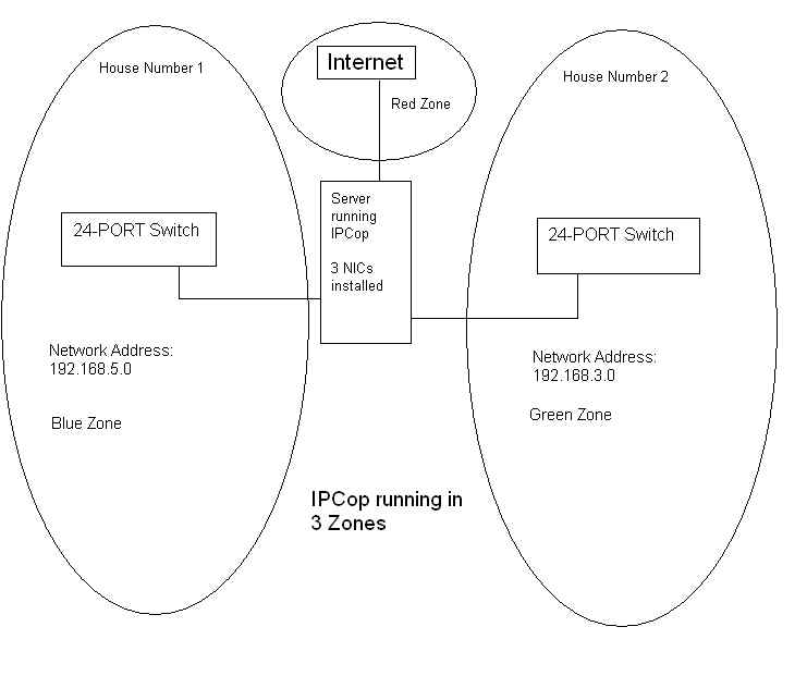

I want more control over the network so I've decided to ditch the router and build an old Pentium 3 spec machine that will run either IPCop or Smoothwall. I've run them both through VMware and I like what they have to offer. Smoothwall has better documentation but IPCop has an extra 'blue zone' which I think I need.
I've included some diagrams of the proposed network: One with IPCop running 3 zones and one with Smoothwall running two zones. Which setup and firewall do you think is best for my network?
Can someone go through the pro's and con's of both diagrams?

IPCop. It's a fork of Smoothwall anyway. I'd install the addon engine and the BOT (block outward traffic) module, which will give you access to write advanced firewall rules. I fail to see the advantage of Smoothwall in this environment, so I can't really run you through the pros of that side of the diagram, but you could also implement IPCop with two interfaces in exactly the same manner. The major benefit of configuring the iPrism with two different zones would be that you could easily segregate the two networks, forcing them to act as two individual networks instead of one larger one. Also, the BLUE network zone in IPCop can be used to exclude any PCs which do not have their MAC addresses listed in the zone's allow list. You could also conceivably introduce filtering to one or both zones ala some transparent proxy magic (ala squid) and the Cop+ plugin (ala Dan's Guardian). I don't know if these features are attractive to you, but you can do it.
Another option would be m0n0wall, although IPCop is probably easier to use depending on your networking background. IPCop does support QoS and traffic shaping, but the Linux kernel's shaper is not as nice as the BSD kernel's shaper. OTOH, since m0n0wall is based on BSD, the hardware support is not as good as IPCop, which is based on Linux.
So, ultimately, I believe IPCop would be best for you except in the case that traffic shaping is your number one concern. In that case, take a long hard look a m0n0wall before you implement a firewall.

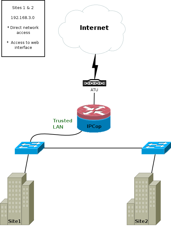

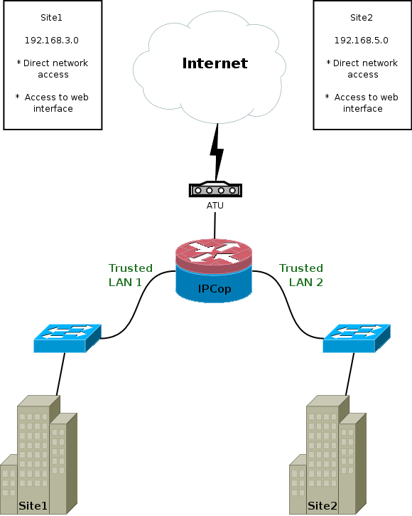

Hey Megamaced, here are three very basic proposals for your network deployment. It's up to you which will suit the need the best! Let me know if you need any additional proposals and I'll work something up.

Graphs two and three would probably be more suitable. I want the network to be 'plug and play' in a sense, so when a new tenant moves in all they have to do is plug in the network cable and away they go. This would not be possible for the 'blue' household in graph one.
Graph two is probably the best way to go but I didn't think it was possible to assign two network cards to the GREEN network? I think I tried it before and it wouldn't let me. That's why I opted for the blue network - to run as an additional green-like network.
Graph three solves the Green / Blue network issue but what of the internet speed for the second house? Will they notice any lag having to go through an additional switch?
No, it's just a layer-2 switch -- store & forward. If the switch is adding latency, you need a new switch. :)
