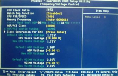

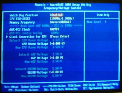

    Thanks Mr B. Think I now know where it's come undone. I eventually squeezed a manual out of Epox and on their 'Frequency/Voltage Control' page they have this screen which shows the 'CPU clock ratio' adjustment:
    and then you have my actual screen in BIOS which has the first line missing and therefore no facility to change the clock ratio.Any ideas mate before I lose the rest of my hair? Thought it may have been a jumper on the board which needed changing, but no such luck.

  6. Big B
    You might try playing with the Memory Frequency option. You might have a 200MHz part after all, and the RAM may be being overclocked higher than it can work at, causing your inability to boot.
