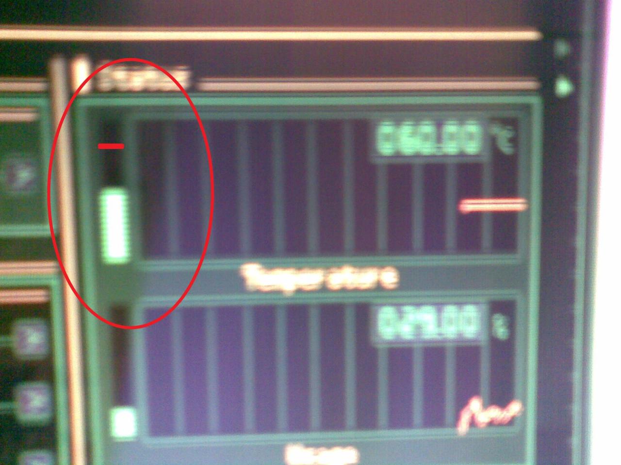

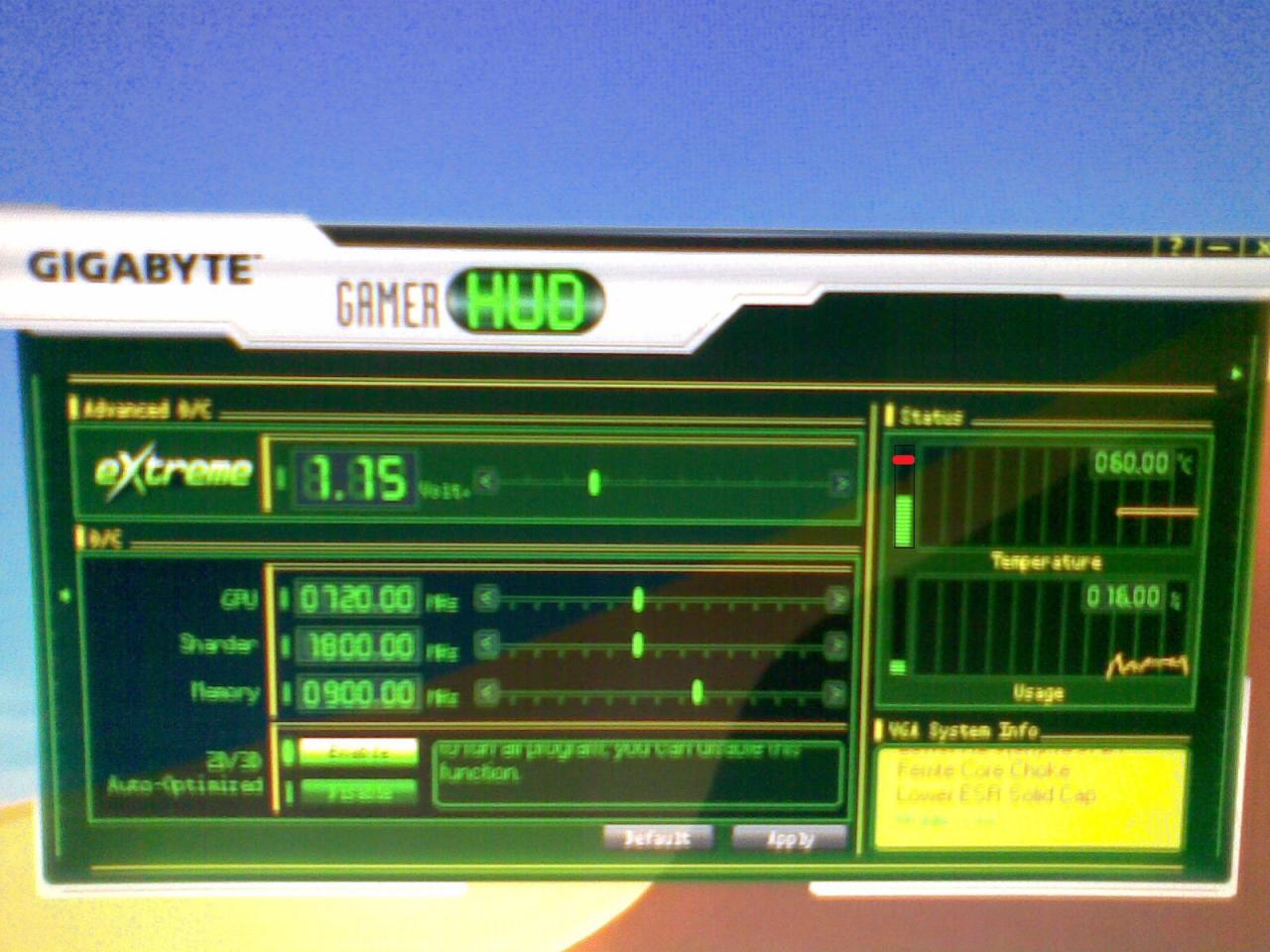

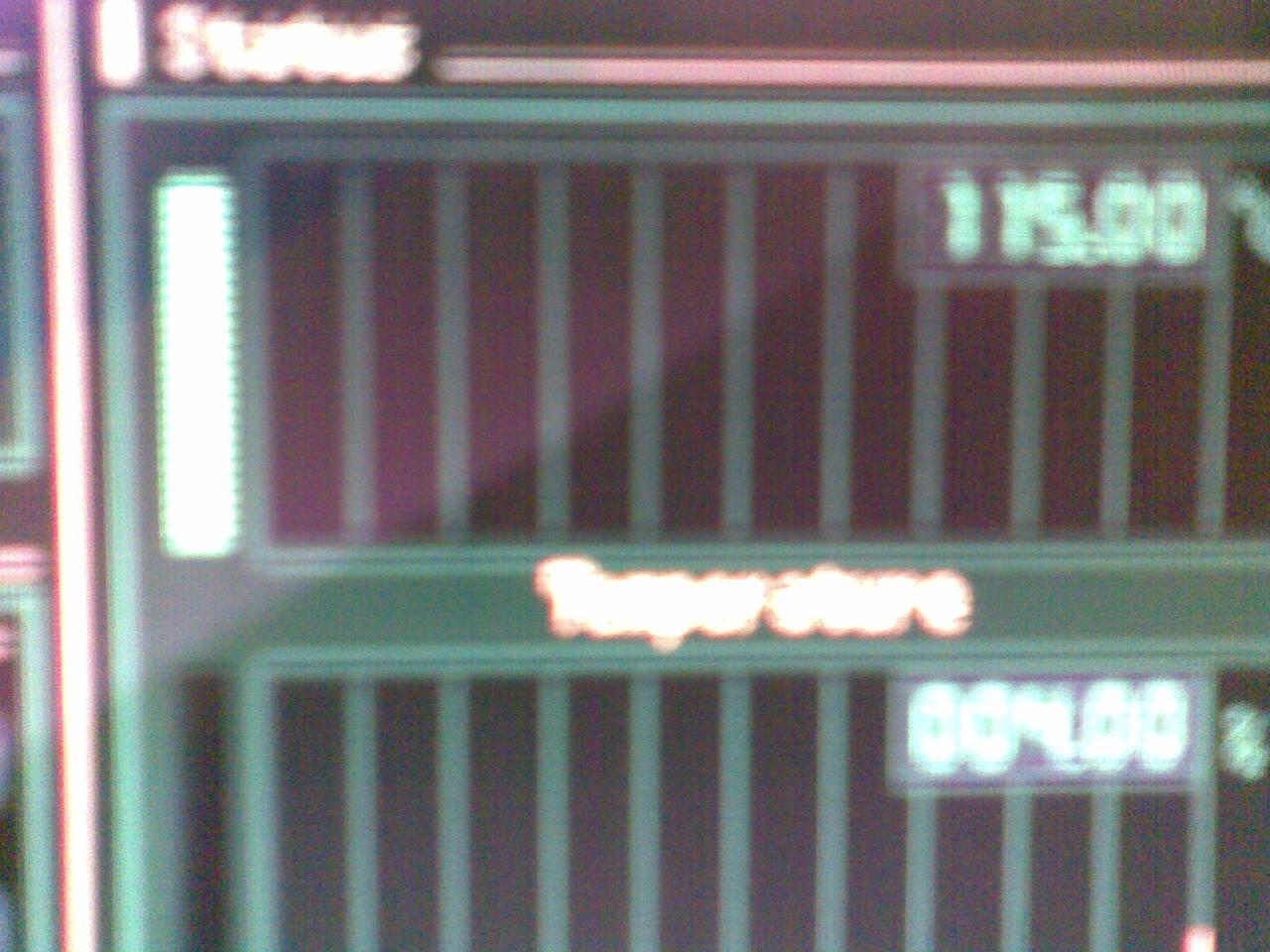

The idle temp does seem high (70 C), as do the load temp of 107 C, should be looking between 40 to 60 when idle and under 90 under full load. (going from past experience)
I think the reason could be a poor quality case, the graphics card might be overheating or alternatively nTune could be reporting the temps incorrectly.
Try this utility to see if it reports similar temps GPU Caps Viewer: Graphics Card Information Utility, GPU Temperature, OpenGL Extensions and API Support | oZone3D.Net

Yes you're right it's too high temp. I tried the utility but the same results. check this out: these are screenshots when i just turned on my pc. It was taken in the gigabyte gamer hud.When the temp is something like 100C the bar goes in the red line.(If you can look at it it has also a small space to go to full. How i can determine if my case is a poor quality?

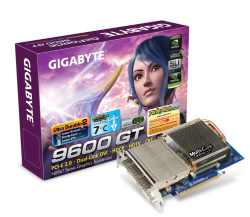

Also look at a screenshot of my 9600GT. It has a big fan but its too silent. I cant even hear it when i work. Do you know if there is a way i can make the fan work harder cuz i dont need it to be silent.

I think [google]NVIDIA System Tools.[/google] should let you control the fan speed. (or you can try EVGA | EVGA Precision but guarantee it will work)
