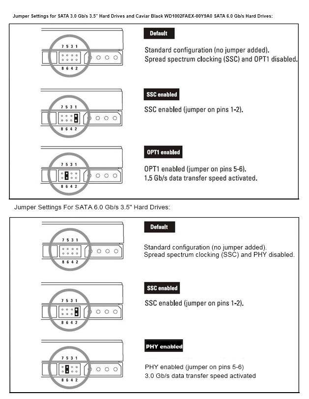

    as far as compatibility with sata 6gb/s drive to a sata 1.5gb/s, i'm seeing that this drive provides jumper settings to go from 6.0gb/s to 1.5gb/s.
    http://wdc.custhelp.com/app/answers/detail/a_id/5387#jumper
    notice how its confusing how it says "jumper settings for sata 6.0 gb/s 3.5 hdds"
    but at the top it says for both 3.0gb/s hdd and the WD1002FAEX.
    my guess is that they chose this size drive to support 1.5gb/s for popularity?
    there are other sizes that have 6.0gb/s and what ... do they have to succumb to 3.0gb/s speeds only?
    maybe someone else can take a look and see if i'm missing something.
    but if i'm right, then yeah this drive should support 1.5gb/s provided that you set the jumper.

    i couldn't find sata jumper settings for this drive. setting a jumper to 5-6 may or may not work. some people complained that this drive may not be 1.5 compatible.

    you can try it out by setting the jumper, put it in the enclosure, and trying it out.

    the jumper settings are to bring the hard drive down to 1.5gb/s.
    the only thing is i'm unsure it will work.
    if you can get the hard drive to work at the 1.5, then i would suggest doing that and using the esata option on the enclosure.

    Well, it seems that I ended up with a WD10EALX. Set the jumper to the 3.0 speed, hooked it up and connected via USB. It's working in Ubuntu. I'll have to report how it does in Windows.
