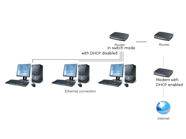

    I'm trying to add broadband to a small network which previously worked fine. Where the modem is now, there used to be a cable that connected the 2 routers either side. When all IP's are manually configured (dhcp off), everything is how it used to be, including no internet (even though it has to go through the modem/router!).
    I've included 2 diagrams showing how it's setup. Please help!!! The aim is to have internet access on DKS (MINILAB), SHOPCOMPUTER, ATHLON64-2GHZ, JAMESCOMPUTER and ACER5050. It's also essential that JAMESCOMPUTER can see shared folders on DKS (MINILAB)!

  4. donkey42
    donkey42 plank
    :confused:
    @RH: the 3 routers are all connected to the modem
    thomas, this would be much easier if you used a single router & 2 switches & it would be much cheaper
    however, if you connect only 1 router to the modem & disable DHCP on the other 2 routers, this effectively converts a router into a switch
    Edit: effectively making your notwork topology look something like the attatchment

  10. donkey42
    donkey42 plank
    ok, what you / they have is an Huawei Echolife 520s - wireless router & 2 switches, i'll get GIMPing your network topological diagram
    BTW: it would take me hours because i don't fully understand networking, so, bear with me please, but a network expert like AT wouldn't take that long
    the only reason i don't fully understand networking is: i only have my single home system to play with & only have other forums & wiki to rely on, but, i'm always learning & willing to try new stuff, anyway, i'll get started with GIMP
  11. donkey42
    donkey42 plank
    it's not brilliant but you get the idea
    BTW: the switches are actually routers with DHCP disabled, one 1 DHCP server should be active
    the only active DHCP server, i think, should be the router connected directly to the net :unsure:

  13. donkey42
    donkey42 plank
    well i wouldn't say that, i didn't even use the correct symbols, but, like i said, you get the idea
    it's actually your original pic with a few bits cut off & some other bits pasted on
    your more than welcome BTW: it's actually my first attempt at a network topology diagram & i'm pleased / glad you like it
  14. donkey42
    donkey42 plank
    turn DHCP on on the router connected directly to the net because if the router has DHCP on it acts like a switch whereas with DHCP on it will fully enable the router, then it may just work
    Edit: if it works, it is because enable or disabling DHCP (very basically) turn routing on or off, obviously it does far more than that, but try it first
    Edit:
    yes, becaus it was acting like a switch, enable DHCP & it should act like a router
