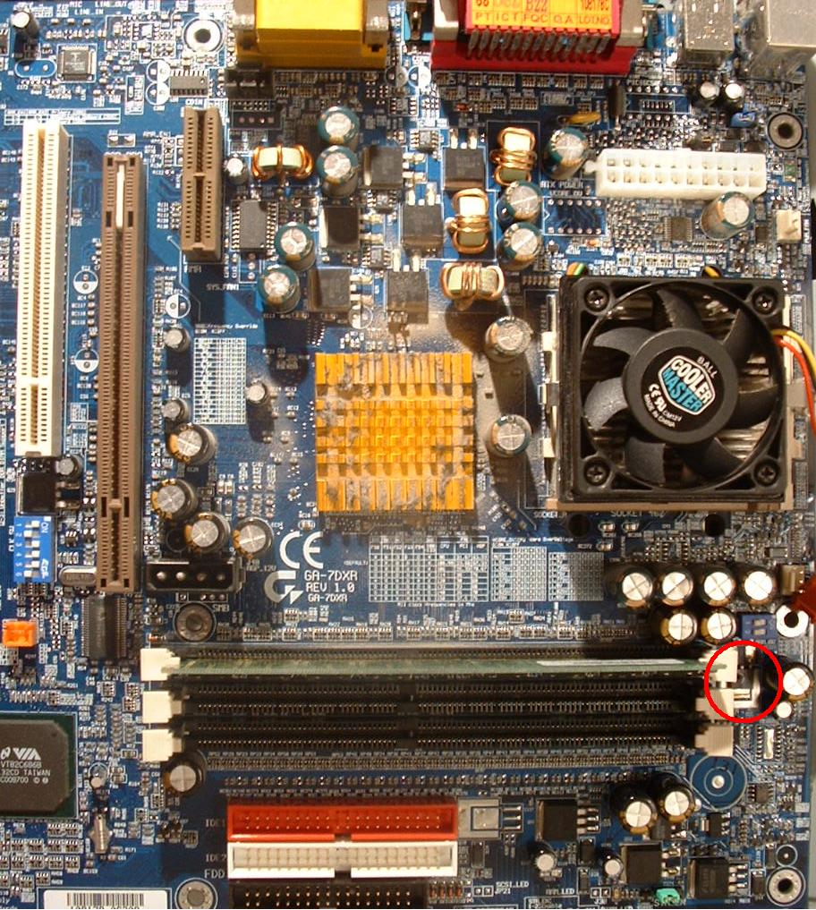

    I was using my PC for revision and listening to music when i knocked the PC while grabbing a folder off the floor.
    Something got upset and the computer froze solid and now all i can get on boot is fans spinning, no beep (POST ??) and nowt work, now managed to nick parents laptop for revision but that got boring quick so i thought i'd investigate, removed all peripherals and that to check for broken bits even though i suspected mb ro psu to no avail. So it got late i left it.
    Anyways next day i takes out the mb to inspect and found:
    **see attachment**
    This thing looks like a transistor but who am i to know :)
    The code on it is C5001 R
    If anybody know what this is and whether i can buy a replacement i'd be damned grateful :)
    Also includeed a picture of my mobo, suspect area is higlighted
    IT's a Gigabyte 7A -DXR revision.1
    Thankyou very much for any hlp in advance, though i'll probably thank you again :)
  2. Anti-Trend
    If something on the board conducted where it shouldn't have, it would certainly explain the schorched components I see here. Really, the only viable solution for you is to replace the motherboard.
    Hopefully the RAM was not damaged as well, but due to the proximity of the failure to your RAM, it is not improbable. When you get your replacement mobo, my advice is to run Memtest86+ on it overnight to test for errors. Even one bad sector on ram is one too many. Of course, this is even assuming the RAM is in good enough working order for the system to even boot with it...
