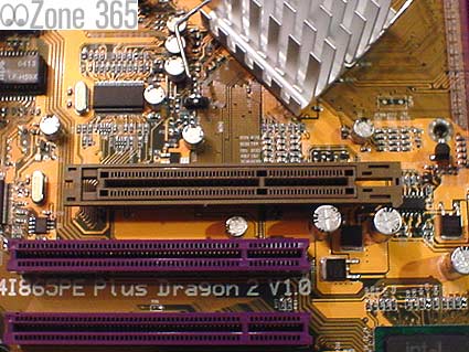

I am aware of the difference in PCI cards and AGP cards however I was told that I would need to see if my motherboard has an AGP slot ?? ??, I dont think it does looking at it but maybe it has (if someone could tell me here is my spec:)

Here’s an example of an AGP slot, but yours might look a little different and might have a white tab at the end. Usually it’s brown and around the middle of the motherboard.
I tried to find the motherboard on FIC’s site, but it doesn’t look to exist, so I’m not sure if it does either.

Thanks for your help with this, It seems I dont have an AGP slot, I presume the only way for me to get one will be to purchse a new motherboard with one in it, This may happen further down the line but for now I can wait.

I might have an AGP port now I think of it, earlier when I opened my PC i noticed something similar to the pic you posted (only looked at in depth after I posted my previous post sorry ), I am gonna take my casing off in 2 secs and take a photo and report back, so if you ccan check my pic and see if it is an AGP port it would be much appreciated.
Yup. It’s an AGP slot.
AGP slots only support AGP video cards (at least commercially). I guess they could support something else, but nothing has really been made (at least that you’d use—there’s some oddball stuff out there).
