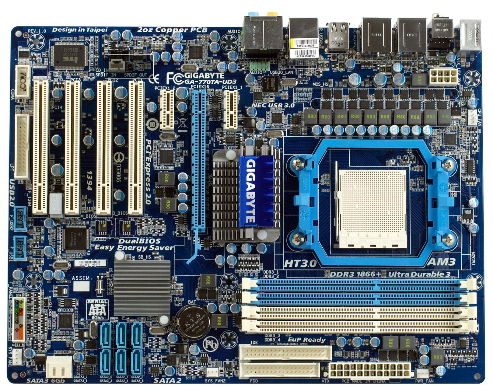

yes i have a cable like this, but my main audio source is audigy se , it doesn’t matter ? my motherboard is this http://www.gigabyte.com/products/product-page.aspx?pid=2960#sp

Nope, you should connect the S/PDIF Out from the motherboard to your graphics card with the wire that came with the GPU. I’ve attached an image with the SPDIF out highlighted on the motherboard (its the black one), your wire should connect to that and the other end to the graphics card, which should also have a similar connector. After that it might just start to work, otherwise its probably down to software configuration.
ok thanks , i will try it and reply
solved ! i connected spdif from motherboard to graphic card and hdmi transfer audio too. thanks
