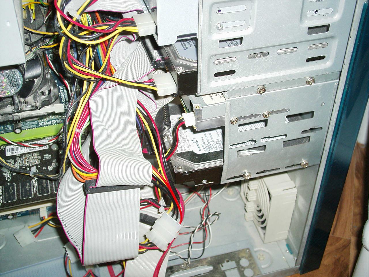

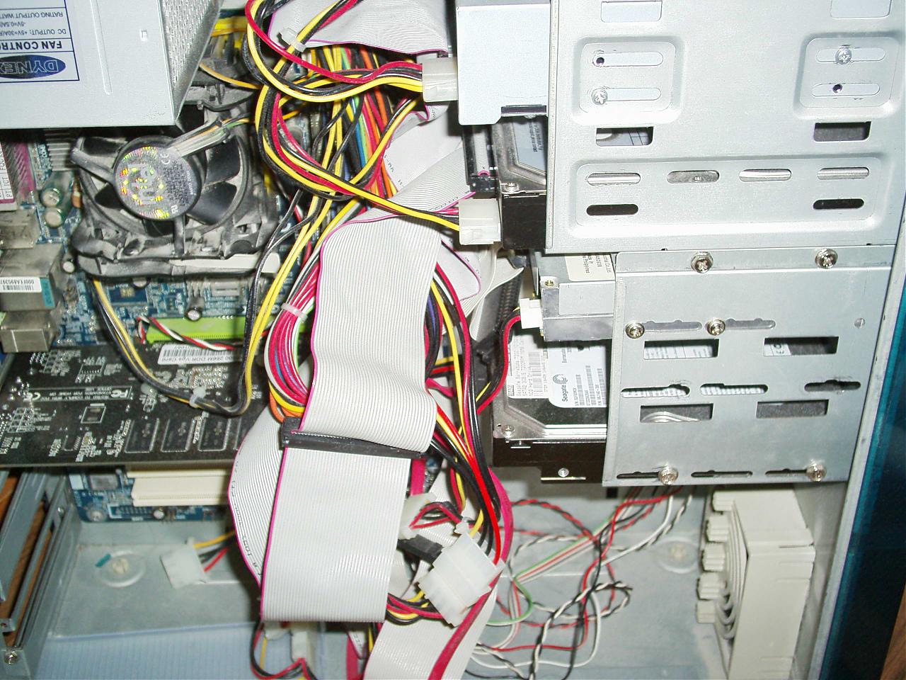

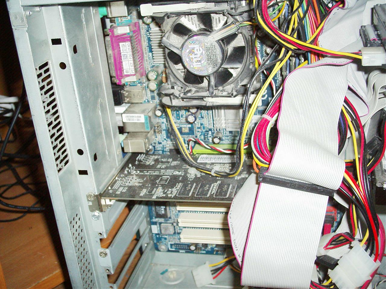

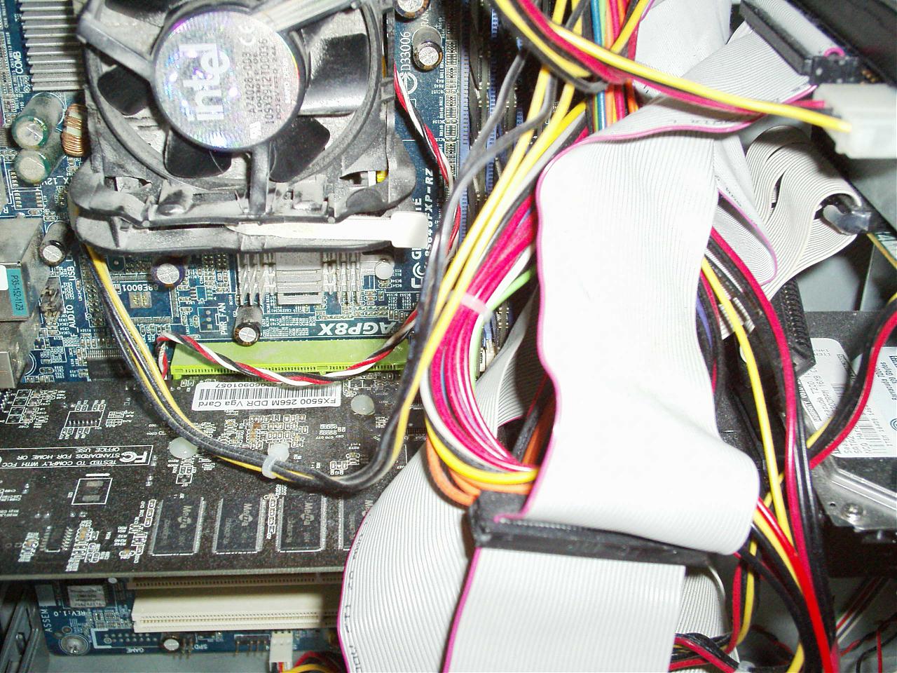

heres the pics of my comp.
i think im going to get a slot fan and hard drive fan to cool things down
Your CPU cooler is filled with dust. You should clean it.

Yeah, dust that sucker out for starters. Secondly, some wire management would do wonders for air flow. Zip-ties are a very inexpensive means of tying up unused wires and holding the rest out of the way.
