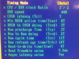

i have seen a review on my cpu, and it shows that my cpu can be at 2.8ghz with a voltage bump, i have got my cpu running at 2.4ghz stable, when i overclock it to 2.6ghz, in the most part, it is stable, exept sometimes i get a crash, or vpu reset kicks in, also, when i overclock my cpu, the memory speed also goes up, and if i overcloed my cpu to 2.8ghz, it would also make the memory clock go higher than 500mhz.
what options should i change in the bios to stop the memory from clocking so high, also, what voltage bump should i do.

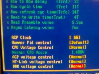

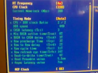

i have included some pics of the bios, sorry about the bluryness, i used my camera phone.
as you can see, the ddr speed is 440 as te cpu is at 2.4ghz, i need to get the voltage lower, back to normal.

To keep your RAM speed down while increasing your FSB you’d need to change the FSB: RAM Speed Ratio, (First picture I think…)
Change it to something like 3:2 (FSB: RAM respectively) and see what you can get, this will mean you can get the FSB of the CPU higher while keeping the RAM speed down.

ah right thanks, and what about increasing voltage of cpu?
should i increase it from 1.4v to 1.6v?
trygin to get 3700+ amd64 (2.2ghz to 2.8ghz.)
Don’t try a voltage boost yet. Try getting to 2.8GHz and see what happens, if it doesn’t post or your BIOS resets the speeds then try a small voltage bump, something like 0.05V at first and try again, don’t bump things up too much at once or you risk damaging things. Remember increasing the voltage increases the temperature of the CPU so watch it to make sure it stays at a reasonably safe temperature.

First off, to overclock you need memory that is preferably capable of the FSB you will be overclocking your memory to. You have PC3200, this is capable of running @ 200Mhz FSB (DDR400).
What make is it? because unless its a good solid stable make / brand, you may only get a maximum of 210-220Mhz from your FSB. (not alot).
What you should do is this:
Increase your memories Latency timings to: 3-4-4-8 2T - this is a slow latency, and will decrease performance, BUT and its an important but, it will erradicate the posibility of your overclock failing due to your memory timings being to fast for the overclock you are trying to use.
Now set your CPU:FSB Ratio to 3:2 or something higher, this will underclock your Processors clock speed, but keep your memory running the same (from 200Mhz & upwards when u overclock). - This means you won’t risk damaging your CPU from a bad overclock, or heat issues.
Second, without increasing your voltage of your cpu, try overclocking the memory’s FSB as far as you can go in 2Mhz increments (2Mhz at a time), rebooting and trying Windows + 3D Games for 10 - 15 minutes solid. (run a disk defrag in the back ground as well).
Now once you find it becomes unstable, underclock it to the previous overclock that was stable. Now what you’ll want to do is increase the Voltage thats supplied to your memory "Vdimm) (don’t go higher than 2.8V as this is unsafe for generic or standard non overclocking memory).
Now increase the Voltage by one step, from 1.4V to 1.425V, now increase the memories FSB by 2Mhz increments until you find another unstable overclock. Underclock again, and go back to a stable FSB setting, now increase the memory.. to 1.45V, now overclock again.. underclock, increase voltage, overclock.
Carry on doing this until you find the maximum stable overclock of your memories FSB. Now once you find your maximum FSB Overclock, decrease it by 4 - 6MHz FSB increments just to be safe.
Now make sure you have a good CPU Cooler and good air flow through your system, and change the CPU Ratio from 3:2 or what ever so the ratio between the two becomes smaller and smaller.
Start increasing the FSB of your CPU in 2Mhz Increments until you find an unstable overclock, now take it back to the last stable overclock you found and increase the Voltage to the CPU by 0.025 (VCore). And do the same method as used above in the memory.

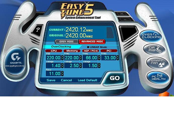

When you say increase the memory fsb, is that ddr speed thats showing up as 440mhz in the 1st picture?
i have taken a screenshot of easytune, that shows everyhitng alot more clearly.

The memory fsb is the one on your image that says: Mem Freq (Memory Frequency or Memory FSB Frequency).
DDR = Double Data Rate
PC2100 = 133Mhz (because its DDR it’s: PC2100 DDR266 (2x133 = 266)
PC2700 = 166Mhz (because its DDR it’s: PC2700 DDR333 (2x166 = 333)
PC3200 = 200Mhz (because its DDR it’s: PC3200 DDR400 (2x200 = 400)
If your computer settings were:
AMD 64 3200+ 939Pin (2.0Ghz or 2000Mhz)
2 x 512MB PC3200 DDR400
The AMD 64 3200+ (and all AMD 64 processors except FX range) would have a Multiplier of 10.0x.
If you’re motherboard was set to a 1:1 CPU:FSB Ratio (meaning the CPU’s FSB runs the same at which the memory FSB is set to).
And you increased the Memories FSB from 200Mhz (default @ PC3200) to 220Mhz here’s the math:
Both CPU & Memory are running @ 220Mhz so thats 210HT (HyperThreading) (as Hyperthreading runs 1:1 with memory FSB as well - this ratio can also be changed as the CPU can)
220HT
Now, both your memory and CPU are running at a frequency of 220Mhz, so your memory is running at DDR420 (2x220Mhz = DDR420)
Now because your CPU FSB is running @ 220Mhz, the actual clock speed of the CPU or Processor is worked out by this:
CPU FSB x CPU Multiplier
The AMD 64 3200+ is 10x Multiplier, so, 220Mhz (CPU FSB) x 10x Multiplier = 2200Mhz.

if i have the ht on 5x, then overclock cpu to 2.6ghz in windows, windows crashes, so i have to restart the computer, but if i increase it to 2.6ghz in bios and have 5x ht on, then everyhitng locks up, and i have to reset cmos.
why could this be happening?

First off i recommend that you do not allow your CPU to run at more than 55C, the life expectancy will dramatically weaken, plus its winter.. wait till it get hotter say 10-15C hotter - so will your cpu. and thats too close to the 65C - 70C. Understand? :slight_smile:
Right, if you obviously have either misunderstood or not understood my previous post, if you just “bump up” the CPU to an overclock of 2.8Ghz, it most likely will not work as you are using default Voltages.
You must overclock gradually, find unstable overclocks, then increase the voltage on both the memory / cpu as necerssary until you find your overclock becomes stable.
You should NOT push your CPU past 1.6V unless you have water cooling, or a phase change kit (freezes the cpu).
Also, bare in mind that on each overclock, you need to test it, by running your CPU as hard as possible (ie make it work, so you know even when its being pushed it will work with the overclock).
If you just bump it straight up to 2.8Ghz you risk damaging your cpu, through heat, lack of power because you havnt provided enough Vcore, damaging your memory due to lack of power because you havnt provided enough Vdimm.
Believe me, if you do not overclock slowly, and thoroughly test your overclock, you’re CPU WILL DIE. (and a bad overclock can also take along other components like graphics cards & motherboards) and overclocking is not covered by any warranty.
As for your problem with HT, HyperThreading by default runs @ 1000Mhz (2000 HT) it is worked out as such:
HT = HyperThreading, hyperthreading is worked out by this calculation:
HTSETTING x CPU FSB
of course your CPU FSB is calculated from the Memory Frequency or Memory FSB
so example:
Your running a 1:1 ratio, you set your memory FSB to 220Mhz, therefore your CPU FSB is running at 220Mhz as well, your multiplier of your cpu is 10x, 10xCPUFSB = 10x220Mhz = 2.2Ghz or 2200Mhz.
Your HyperThreading speed is set to: 5x (HTSETTING x CPUFSB = HyperThreading Speed)
So:
5 x 220Mhz = 1100Mhz or 2200 HT
The problem you have is that HyperThreading doesnt like to be overclocked, so it’s a limiting feature, what i recommend is that you lower your HTSETTING (currently 5x to 4x or 3x) Overclock your CPU using the method i have given you and then increase the HT later, to the fastest you can.
Realistically you can’t overclock HT past about 1200Mhz on good overclocking boards.
You need to get run:
Slow latency on your memory such as: 3-4-4-8 2T (as you overclock your memory FSB, your memory will be running at higher clock rates, higher clock rates don’t like running at tight timings (or low timings such as: 2-2-2-5) - this is a limiting factor and will crash your memory and stop you from overclocking if your latency is too fast for the memory to run at. Running lower latency memory also requires more Vdimm (voltage to be supplied to your memory).
HT should be set @ 3x or 4x as once this is overclocked too much it will stop u from overclocking your CPU anymore (limiting factor)
If you dont overclock properly, you may limit your CPU’s maximum overclock, if you do it right i guarantee you’ll get alot more than you expect.
And before you start overclocking, get a good HSF as we mentioned before, the Artic Freezer 64 is a reasonable cooler, although there are alot better coolers out there now, i would buy a Zalman 7700CLU (£30 but its one of the best HSFs out for silence and cooling).
Make sure you have good fans as well, perhaps even one above your memory too cool that down as well.
