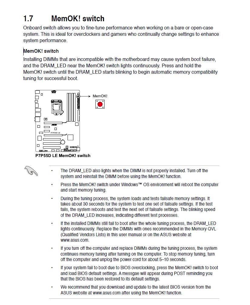

have you read your motherboard’s manual?
read up on this if you haven’t already and see if this helps.
