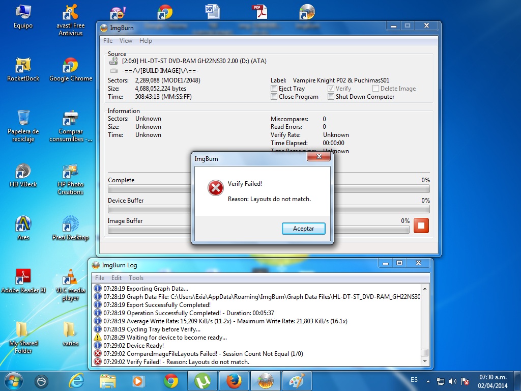

When i’m burning a dvd i don’t have any problem and complete the process sucessfully but when i put the recently burned dvd the wirter read it’s like a blank dvd and i prooved the burned dvd in a friends house and can read the dvd it’s somebody can help me i’ll be grateful.
And i checked the dispotives manager and appear the dvd-writer it’s ok, it doesn’t appear a problem.
IMGBurn version? Try latest.
Write speed was? Try slower speed.
The fastest 16x.
Try slower then.
try a different Burning Software… like Ashampoo burning Studio… They make a free version..
I’d already try with Nero, Img Burn and CD burner and give me the same problem i even re-instalated the driver and still happens.
How Old is this Cd/Dvd burner ?
It’s a remenber well a litle more than 3 years, but that’s the odd part because in the devices manager appear it’s working corrrectly but today or tomorrow i will buy a new one.
Device manager only tells if it can connect device and get no error codes. Not that device is really working.
In other words my burner is a living dead and thank’s i already made my mind that a have to buy a new one.
