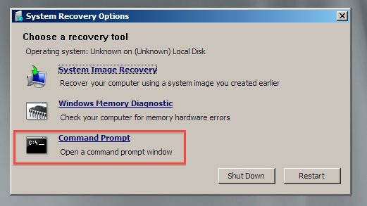

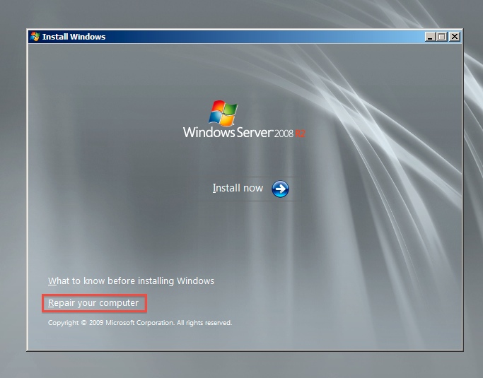

Instead of using the Recovery Console, insert your Windows disc and launch Setup. Choose Repair your Computer instead of Install Now.
Choose your current Windows installation and then choose Command Prompt.
In this example I’ll restore the Registry file ‘system’.
  1. Backup your original file.
cd C:\Windows\system32\config ren system system.old
2. Restore the original file.
cd C:\windows\system32\config\RegBack copy system ..\system
You can now reboot your system.
