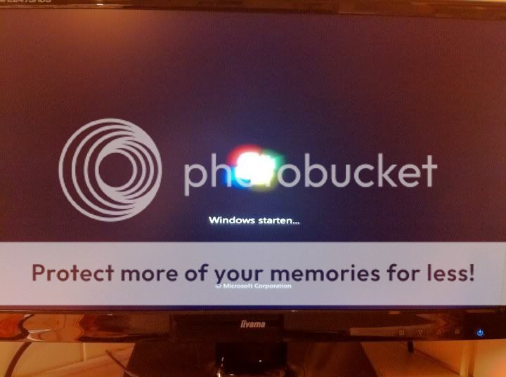

Recently I’ve purchased a new graphicscard, with a Radeon HD6870 GPU. Naturally, I tried to install it. But, after running into a few different problems, I rebooted my PC with the 6870 in it, and every time I do this now with the 6870 in it, it gets stuck on the Windows 7 loading screen. (See SS below)
Now, the strange thing is, when I turn on my sound, while I wait for this loading screen to pass, I do hear the sounds of Windows booting up, skype booting up and msn booting up, and the occasional sounds of notices.

Also, that’s the problem, lol. When it’s stuck at that Windows loading screen, nothing else will show up. Its literally stuck on there. The task manager wont show up either, it just stays at the windows loading screen. However, as I mentioned before, when I turn on my speakers, I do hear the jingles of Skype, MSN and windows itself booting up, and I hear the occasional tunes of error messages, notifications, etc. too.. So yeah, the second resolution wont work out. :S

And nope, doesn’t work either.. Same problem, it stays put on the Windows 7 logo.
