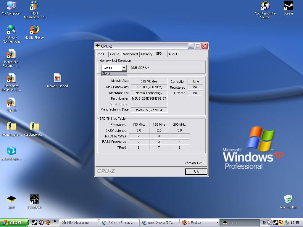

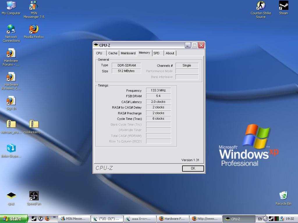

    ok well ant this strang ok first i power down a remove the ram and put it in slot 2 power up, do memtest fine but i realize that is running at 133mhz instead of 200mhz but oh well so i cary on not error by the way from memtest and i cheak that its running at 133 trough cpu-z and i wanna know y this is??????? i have changed it in the bois and im confused here are some pics to help you

    That's what I thought. The nForce 2 chipset your motherboard uses has issues running CAS 3 timings. Neither one in itself is bad, but the nF2 simply does not play well with CAS 3 timings, and that's what timings your RAM works on @ DDR400 speeds.
    However, there's some light here. The nForce 1/2 performs best with the RAM:FSB ratio set 1:1. Setting the RAM speed higher, oddly enough, will lower performance a little. My guess is that your CPU works with a 133MHz (DDR266) FSB, and that's why the BIOS defaults to it. You may have changed the RAM:FSB ratio before to 2:3 or something which allowed the RAM to work at DDR400. However, given the nF2's inability to play with CAS 3 timings, that's probably the reason you were experiencing issues.

    nope couldnt find anything only things i found is the voltage setting which anrt propa (high,normal,low) so i think the bois is really crapy mmm and it says that my ratio cpu:dram is 5:4 (in cpu-z) but i cant find it any where ill find out my bois version and tell you but in the mean time any help would be wonderful
