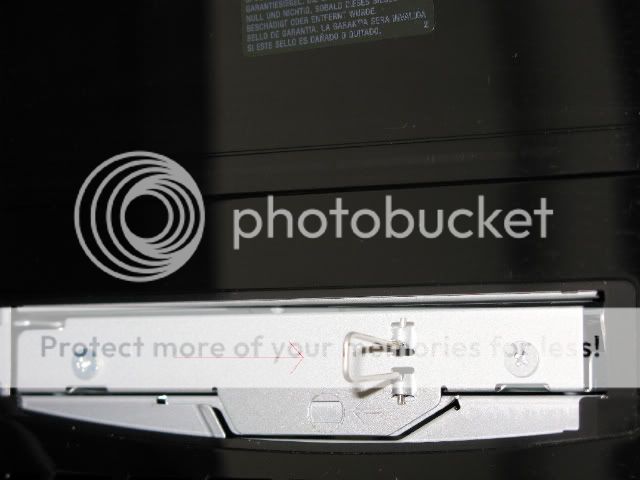

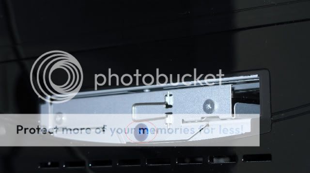

    1. Locate the HDD bay to the left of the PS3. It is covered by a small plastic cover. Once you have located it, remove the cover.
    2. There should be a (blue) screw (marked in the image below). Unscrew it.

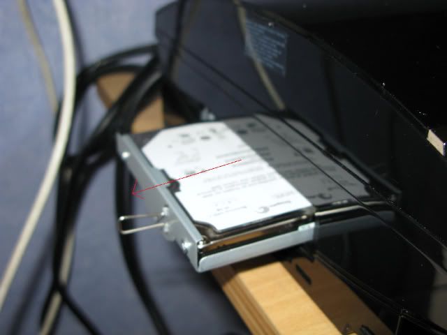

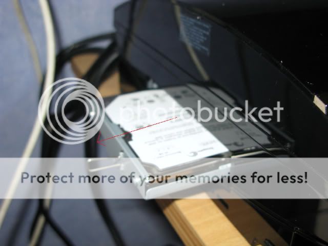

    3. Grab the metal handle, and pull the HDD all the way to the right.

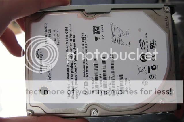

    4. Now pull the disk out of the PS3.

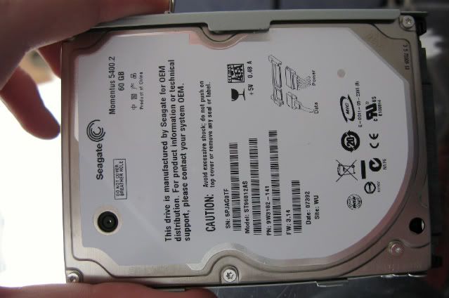

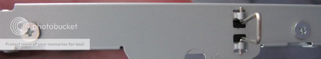

    5. The HDD sits inside a case where it needs to be released from. There are 2 screws on each side. Unscrew all of them.
    6. Remove the HDD from the case by sliding it out and put the new HDD in it. Put the 4 screws back, and then slide the case back into the PS3.
